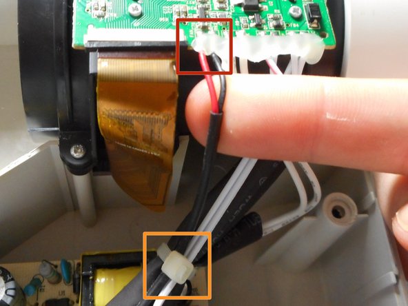

    1. Merch Source Projector Entertainment II Cooling Fan Replacement, Cooling Fan: crwdns2935265:04crwdnd2935265:01crwdnd2935265:02crwdne2935265:0 Merch Source Projector Entertainment II Cooling Fan Replacement, Cooling Fan: crwdns2935265:04crwdnd2935265:02crwdnd2935265:02crwdne2935265:0
      • Locate the 80 mm fan and slide upward straight out of the housing.
    2. Merch Source Projector Entertainment II Cooling Fan Replacement: crwdns2935265:05crwdnd2935265:01crwdnd2935265:02crwdne2935265:0 Merch Source Projector Entertainment II Cooling Fan Replacement: crwdns2935265:05crwdnd2935265:02crwdnd2935265:02crwdne2935265:0
      • Unsolder the red and black connections off of the motherboard.
      • If there are zip ties around the cables, they will need to be cut to remove the fan.
      • Need some help? Follow this guide to learn soldering basics.
      • While soldering the metal connections will get very hot. Never touch the iron with your hand.
      • Make sure that the projector is fully turned off and not plugged in. Allow up to 30 minutes for projector to cool down.
      • If there is hot glue within the connection in on the motherboard, you will need to peel it off simply using your fingers.
