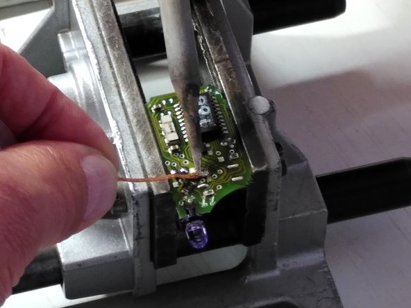

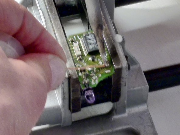

  3. Mercedes-Benz infrared car key repair, Cleaning off the old solder: crwdns2935265:03crwdnd2935265:01crwdnd2935265:03crwdne2935265:0 Mercedes-Benz infrared car key repair, Cleaning off the old solder: crwdns2935265:03crwdnd2935265:02crwdnd2935265:03crwdne2935265:0 Mercedes-Benz infrared car key repair, Cleaning off the old solder: crwdns2935265:03crwdnd2935265:03crwdnd2935265:03crwdne2935265:0
    • Before you do that, however, you'll need to remove all remains of the old solder joints.
    • Apply heat to the joint. Once the solder liquifies, clean the spot with the desoldering braid.
    • The soldering iron radiates extreme heat! Be careful not to damage the capacitors, or you've had it.
    • Make sure to do that on all four joints.

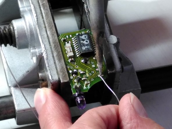

  4. Mercedes-Benz infrared car key repair, Apply new solder: crwdns2935265:04crwdnd2935265:01crwdnd2935265:02crwdne2935265:0 Mercedes-Benz infrared car key repair, Apply new solder: crwdns2935265:04crwdnd2935265:02crwdnd2935265:02crwdne2935265:0
    • Now, you can start to re-apply new solder to the four spots that should hold your button in place.

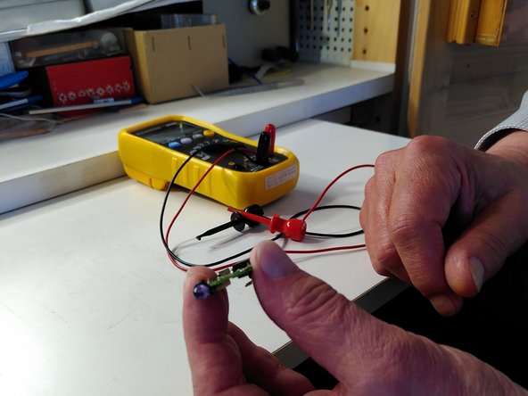

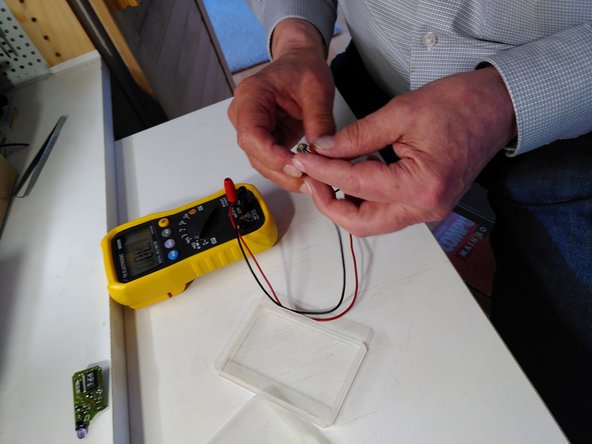

  5. Mercedes-Benz infrared car key repair, Check function: crwdns2935265:05crwdnd2935265:01crwdnd2935265:03crwdne2935265:0 Mercedes-Benz infrared car key repair, Check function: crwdns2935265:05crwdnd2935265:02crwdnd2935265:03crwdne2935265:0 Mercedes-Benz infrared car key repair, Check function: crwdns2935265:05crwdnd2935265:03crwdnd2935265:03crwdne2935265:0
    • Once you've re-soldered all four joints, take the board out of the vice and check the function with a multimeter.
    • While you won't be able to see the infrared light with your bare eyes, a smartphone camera should do the trick.
  6. Mercedes-Benz infrared car key repair, Reassemble the key: crwdns2935265:06crwdnd2935265:01crwdnd2935265:01crwdne2935265:0
    • This is how your board looks like when you're finished.
    • Now, carefully reassemble the key.
    • In some cases, you may have to glue the housing together.
