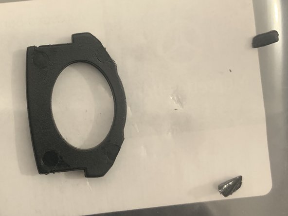

  1. Mercedes W123 key head repair, Original state: crwdns2935265:01crwdnd2935265:01crwdnd2935265:02crwdne2935265:0 Mercedes W123 key head repair, Original state: crwdns2935265:01crwdnd2935265:02crwdnd2935265:02crwdne2935265:0
    • In my case, the original cast key head tore and is therefore no longer stable, which made it somewhat impractical to use.

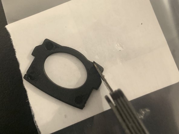

  2. Mercedes W123 key head repair, Uncover key: crwdns2935265:02crwdnd2935265:01crwdnd2935265:02crwdne2935265:0 Mercedes W123 key head repair, Uncover key: crwdns2935265:02crwdnd2935265:02crwdnd2935265:02crwdne2935265:0
    • In the first step we need to remove the old potted key head. This works best with a sharp knife (cutter knife)

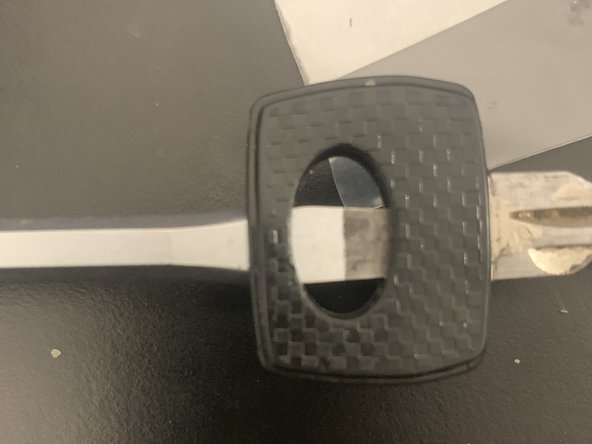

  3. Mercedes W123 key head repair, Push the key into the key head: crwdns2935265:03crwdnd2935265:01crwdnd2935265:02crwdne2935265:0 Mercedes W123 key head repair, Push the key into the key head: crwdns2935265:03crwdnd2935265:02crwdnd2935265:02crwdne2935265:0
    • Now we take the new key head and insert the key.
    • If it's a bit difficult to get in, you can press down with something flat, like a slotted screwdriver.
