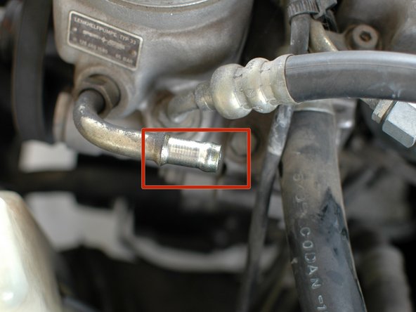

  5. Mercedes W123 Power Steering Low Pressure Hose Replacement: crwdns2935265:05crwdnd2935265:01crwdnd2935265:01crwdne2935265:0
    • Next, loosen the hose clamp on the lower side of the low pressure hose down at the steering gear box. It's just below where you usually will find your primary fuel filter.
    • Once the clamp is loose, pull the line off of the nipple it connects to. Some fluid will likely run out.

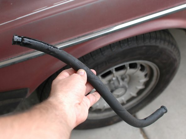

  6. Mercedes W123 Power Steering Low Pressure Hose Replacement: crwdns2935265:06crwdnd2935265:01crwdnd2935265:02crwdne2935265:0 Mercedes W123 Power Steering Low Pressure Hose Replacement: crwdns2935265:06crwdnd2935265:02crwdnd2935265:02crwdne2935265:0
    • Now loosen the hose clamp on the upper end of the hose by the power steering fluid reservoir.
    • Pull off this end of the hose as well.
    • Here you can see the old hose. It was stiff with age, and as you can see quite wet at one end from weeping for the last few weeks.

    • Your reservoir will now be empty. If it is due, now is a great time to change the power steering filter.
    • Check and if necessary clean the two nipples where the low side hose connects.
