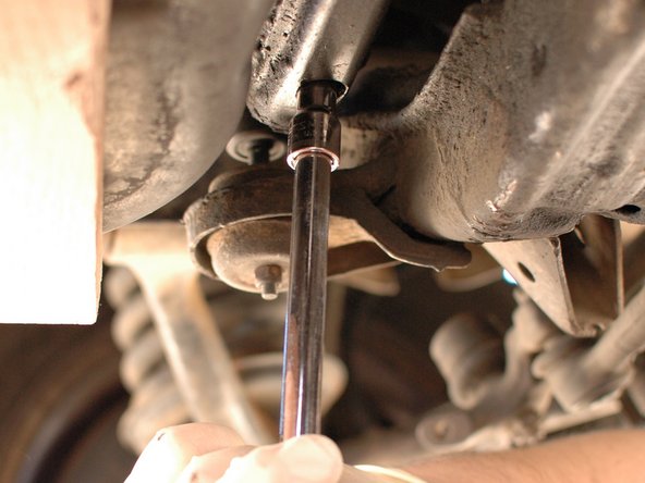

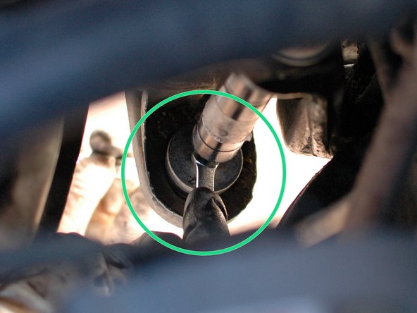

  3. Mercedes W123 Engine Shock, Early Style Diesel Replacement: crwdns2935265:03crwdnd2935265:01crwdnd2935265:02crwdne2935265:0 Mercedes W123 Engine Shock, Early Style Diesel Replacement: crwdns2935265:03crwdnd2935265:02crwdnd2935265:02crwdne2935265:0
    • Remove the 10mm nut on the bottom of the shock.
    • Note that if you try to remove this nut you cannot at first as the shaft on the shock turns along with it.
    • There is a flat area on the shaft, just above the large metal washer on the bottom portion of the shock. Place a 7mm crescent wrench on this to prevent the shaft from spinning. Pictured from above.
  4. Mercedes W123 Engine Shock, Early Style Diesel Replacement: crwdns2935265:04crwdnd2935265:01crwdnd2935265:01crwdne2935265:0
    • Remove the 10mm nut from the top of the shock. Pictured from above.
    • Hold the shock body with your hand while removing the nut to prevent the body of the shock from turning as you turn the nut.
    • Once this nut is removed the shock can be removed from the car by tilting the top away from the engine, out of the slot in the bracket that bolts to the engine, and then by pulling it up out of the hole in the mount on the cross-member.

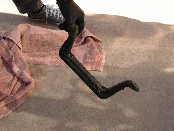

  6. Mercedes W123 Engine Shock, Early Style Diesel Replacement: crwdns2935265:06crwdnd2935265:01crwdnd2935265:03crwdne2935265:0 Mercedes W123 Engine Shock, Early Style Diesel Replacement: crwdns2935265:06crwdnd2935265:02crwdnd2935265:03crwdne2935265:0 Mercedes W123 Engine Shock, Early Style Diesel Replacement: crwdns2935265:06crwdnd2935265:03crwdnd2935265:03crwdne2935265:0
    • OPTIONAL STEP
    • On the car being used in this guide the bracket that holds the top of the shocks was removed in order to fix a cross threaded attachment bolt. If you desire, this bracket can be removed for cleaning; many are very dirty on cars that had leaky oil pan gaskets.
    • Unbolt the two 6mm allen bolts from the bottom of the bracket; they are recessed in the holes in the bracket just inwards from the two shocks.
    • Remove the bracket from the car and clean, then re-install.
    • These two bolts seem to have a tendency to back out of their thread and fall out. Consider re-installing them with blue thread locker.
