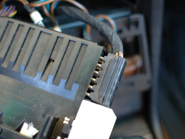

    • With the front panel removed you will be left with just the control unit itself.
    • Gently pull on the four light bulb holders that plug in to the top of the unit to remove them.
  5. Mercedes W123 Climate Control Unit v2 Replacement: crwdns2935265:05crwdnd2935265:01crwdnd2935265:03crwdne2935265:0 Mercedes W123 Climate Control Unit v2 Replacement: crwdns2935265:05crwdnd2935265:02crwdnd2935265:03crwdne2935265:0 Mercedes W123 Climate Control Unit v2 Replacement: crwdns2935265:05crwdnd2935265:03crwdnd2935265:03crwdne2935265:0
    • Then pull off the two large plugs, one on each side of the control unit. Don't pull or pry too hard or you risk pulling the cover off the back of the plugs instead, potentially sending wires everywhere! Just take your time and wiggle them off gently.

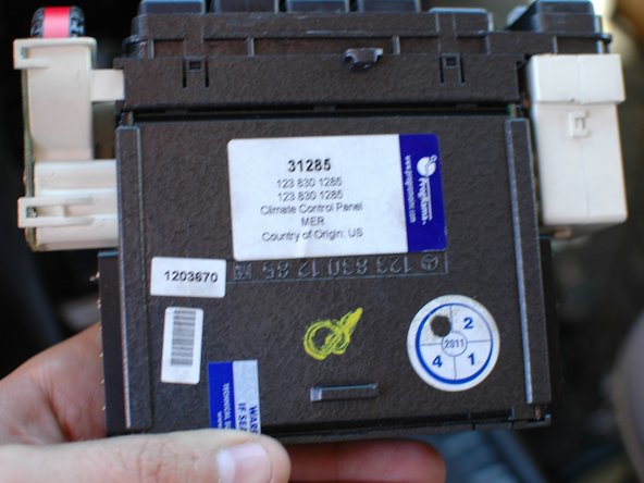

    • You can now remove the control unit and perform any work on it you need to (re-soldering of cold joints, for example) or you can install a refurbished unit like the Programa unit pictured.
