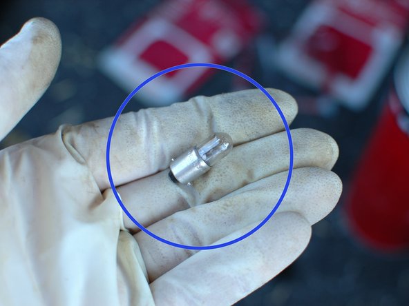

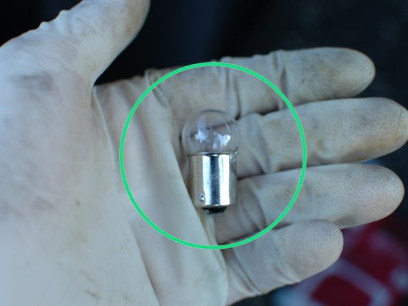

    • Three of the bulbs are #1156
    • One is a #96
    • One is a small 4W blub
