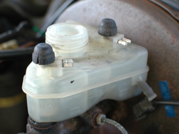

    • There are a total of four rubber seals that help to keep brake fluid inside of your reservoir during use. When the rubber ages, it can crack, and harden leading to the potential for leaks.
    • The first pair of seals cover the brake fluid sensor floats. They can be easily seen on top of the reservoir. These are very visibly cracked.
    • The second set of seals, also called plugs, seal the area where the reservoir enters the master cylinder.

    • Now you can proceed to remove the reservoir. Start by unplugging the two sensor wires from each of the two floats.

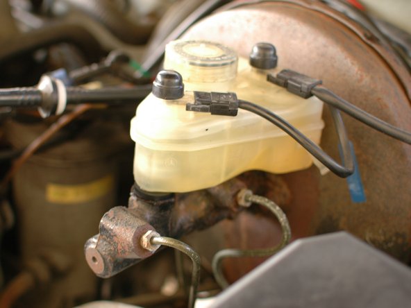

    • With the sensor plugs disconnected you can simply pull the reservoir out of the master cylinder. Pull straight up. It may take some force. You will have a bit of brake fluid drip and splash at this point - have a bit of water ready to rinse it off the painted surfaces underneath.

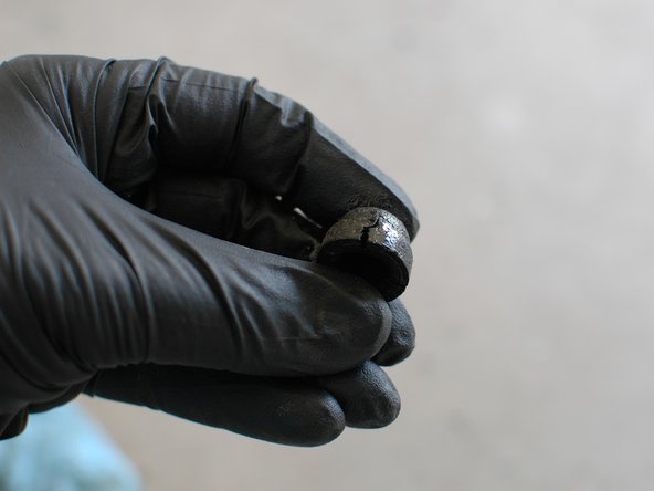

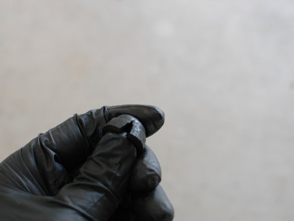

    • With the reservoir free you can pull the seals off the sensor floats. They should pull off with just some prying with your fingers.
    • See the second and third picture to get a good view of the condition of these seals once pulled. You can see for yourself why these were leaking!
