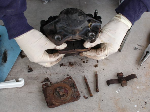

    • The old pads can now be slid out of the caliper. With the caliper off of the car they can slip out either direction. With the caliper on the car they will only slip out away from the brake rotor.
    • If your pads look this dirty and rusty upon removal, consider removing the calipers for inspection and cleaning.
