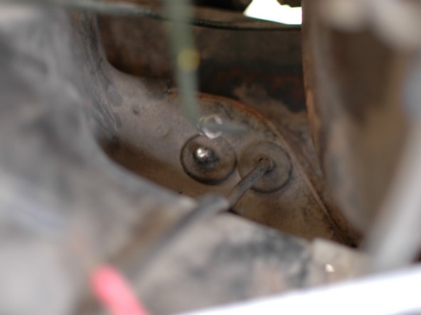

  5. Mercedes W123 Brake Line, Front Driver's Side Replacement: crwdns2935265:05crwdnd2935265:01crwdnd2935265:02crwdne2935265:0 Mercedes W123 Brake Line, Front Driver's Side Replacement: crwdns2935265:05crwdnd2935265:02crwdnd2935265:02crwdne2935265:0
    • The hard line on this side goes down through a rubber grommet in the fender.
    • Pull the line up and out of this grommet.
    • You can now begin to install the replacement brake line.
    • Since you opened up the brake system to the air you will need to bleed the system before driving. Never drive a car after working on the brake lines without first bleeding it properly. [crwdns2936915:0crwdne2936915:0]
