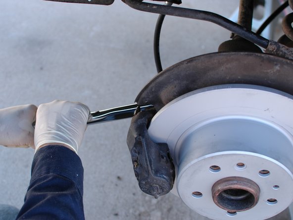

  1. Mercedes W123 Brake Disc, Rear Replacement, Remove the caliper: crwdns2935265:01crwdnd2935265:01crwdnd2935265:01crwdne2935265:0
    • You will first need to remove your wheel to complete the remainder of this job.
    • Then unbolt the two 19mm bolts on the back of the caliper. They are in very tightly and held in by thread locker, you may need a long wrench or breaker bar to remove these.
    • Lift the caliper off of the rotor and hang it with a wire hanger from the sway bar or other strong point on the car. Do not let the caliper hang by the brake hose, this can damage the hose leading to an unsafe driving condition.
    • Or, optionally, remove the caliper from the car for cleaning and new pad install. See the caliper replacement and break pad replacement guides.
    • The rear rotor can then be simply pulled off. If it seems to be stuck to the rear hub, tap around the outside of the rotor with the wooden handle of a hammer, or a rubber mallet, to break it loose.

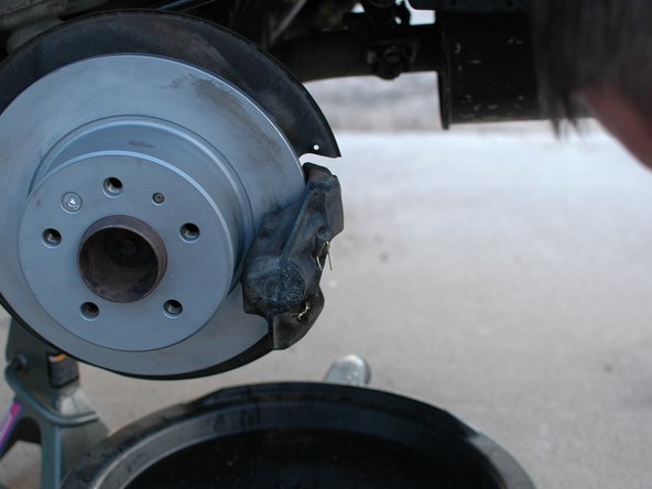

  2. Mercedes W123 Brake Disc, Rear Replacement, Inspect the rear hubs: crwdns2935265:02crwdnd2935265:01crwdnd2935265:01crwdne2935265:0
    • With the rotor off the rear hub is exposed. It may be quite rusty like this. If the rotor was seized to the hub it was because of this rust.

This is a great, well illustrated guide. I just want to add that the parking brake shoes need inspection and may need adjusting.
After step six, the star wheel can be rotated with a flat blade screwdriver. Access is through one of the lug bolt holes if rotated to about 10 o'clock position on the driver side (and about the 2 o'clock position on the passenger side). Just rotate the star wheel until the shoes are tight enough to prevent the rotor/drum from rotating and then back off about 3 clicks.
There are also cable adjustments in board from the drivers side brake to equalize the tension on the two drums and to give the proper amount of travel when the parking brake petal is pressed.

Love the explanation how to take the disc off, tap it off, and then you show a picture (step 2) of a parking brake shoe minus its friction material. If there is a lot of resistance, the possibility is a lip has formed on the drum part, so backing off the adjuster for the parking brake is needed to remove the rear disc/drum. Otherwise get ready to buy a couple of new parking brake shoes (so as not to be a parking “break”).
