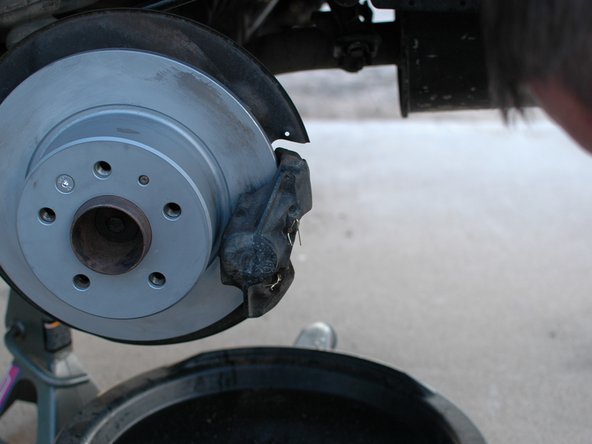

    • You will need to remove your wheels before you start.
    • Before beginning on removal of the calipers you should drain the brake fluid from them.
    • This is done through the bleed screw on each caliper.
    • Loosen this and let it drain in to a proper drain pan.
