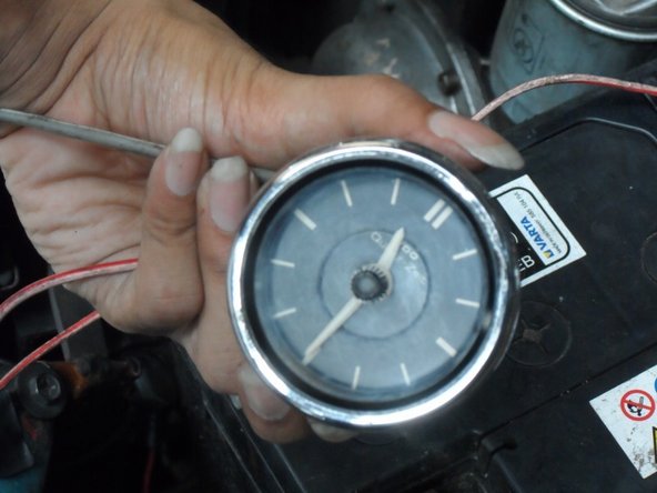

    • Locate the area that houses the clock. Unscrew the two barrels and place it aside.
    • Carefully pull out the clock without damaging any other parts.
  2. Mercedes W114/W115 Cluster Clock replacement and troubleshooting: crwdns2935265:02crwdnd2935265:01crwdnd2935265:03crwdne2935265:0 Mercedes W114/W115 Cluster Clock replacement and troubleshooting: crwdns2935265:02crwdnd2935265:02crwdnd2935265:03crwdne2935265:0 Mercedes W114/W115 Cluster Clock replacement and troubleshooting: crwdns2935265:02crwdnd2935265:03crwdnd2935265:03crwdne2935265:0
    • Connect the screw (located behind the clock) to the negative supply of the battery, and then the small pin to the positive supply.
  3. Mercedes W114/W115 Cluster Clock replacement and troubleshooting: crwdns2935265:03crwdnd2935265:01crwdnd2935265:03crwdne2935265:0 Mercedes W114/W115 Cluster Clock replacement and troubleshooting: crwdns2935265:03crwdnd2935265:02crwdnd2935265:03crwdne2935265:0 Mercedes W114/W115 Cluster Clock replacement and troubleshooting: crwdns2935265:03crwdnd2935265:03crwdnd2935265:03crwdne2935265:0

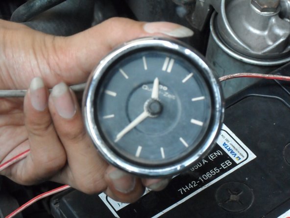

    • To check the clock, set the time to something you can remember and set it aside.

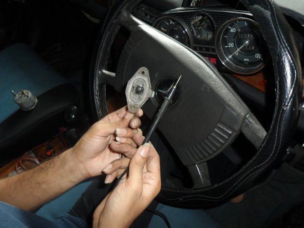

  4. Mercedes W114/W115 Cluster Clock replacement and troubleshooting: crwdns2935265:04crwdnd2935265:01crwdnd2935265:03crwdne2935265:0 Mercedes W114/W115 Cluster Clock replacement and troubleshooting: crwdns2935265:04crwdnd2935265:02crwdnd2935265:03crwdne2935265:0 Mercedes W114/W115 Cluster Clock replacement and troubleshooting: crwdns2935265:04crwdnd2935265:03crwdnd2935265:03crwdne2935265:0
    • To check the power supply of the clock, locate the electrical connector and find the pin on it which supplies the power (12v) to the clock.
    • Take a small bulb and socket and bridge a wire from the 12v pin supplied from the electrical connector, to one of the two wires on the bulb and socket.
    • Next find a ground supply nearby ( the best place would be the key hole) and bridge another wire from it to the second available wire on the bulb and socket.
    • If the bulb lights up, it means your clock has power.
  5. Mercedes W114/W115 Cluster Clock replacement and troubleshooting: crwdns2935265:05crwdnd2935265:01crwdnd2935265:02crwdne2935265:0 Mercedes W114/W115 Cluster Clock replacement and troubleshooting: crwdns2935265:05crwdnd2935265:02crwdnd2935265:02crwdne2935265:0
    • If the bulb lights up, the power supply to the clock is good.
