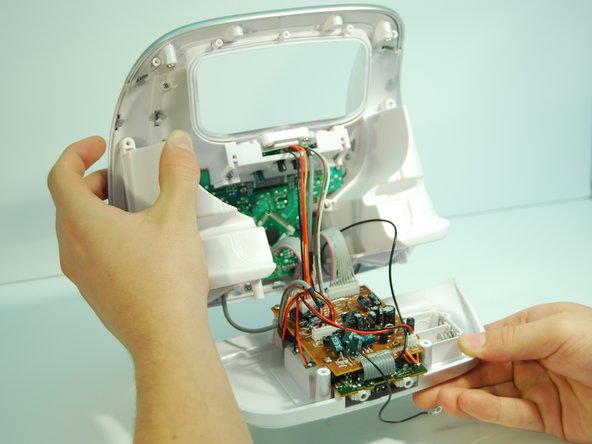

  12. Memorex Mi3X Minimove Speakers Replacement, Radio: crwdns2935265:012crwdnd2935265:01crwdnd2935265:02crwdne2935265:0 Memorex Mi3X Minimove Speakers Replacement, Radio: crwdns2935265:012crwdnd2935265:02crwdnd2935265:02crwdne2935265:0
    • A plastic sheet is in between the radio motherboard (the upper brown board) and the audio port daughterboard (the lower green board) coming from the right speaker housing. Be careful when removing the back panel as to not damage the boards.
    • Remove the bottom panel of the boombox by carefully pulling the panel straight backwards from the boombox until the boards are free.

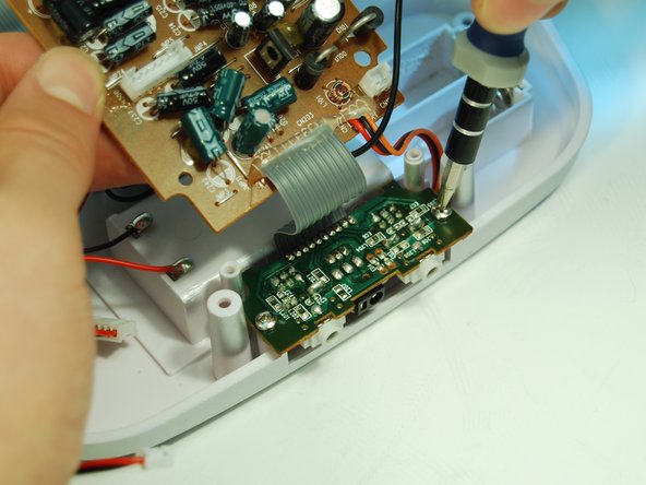

  15. Memorex Mi3X Minimove Speakers Replacement: crwdns2935265:015crwdnd2935265:01crwdnd2935265:02crwdne2935265:0 Memorex Mi3X Minimove Speakers Replacement: crwdns2935265:015crwdnd2935265:02crwdnd2935265:02crwdne2935265:0
    • Detach the smaller green audio port daughterboard by removing the two 8 mm screws with a Phillips #1 screwdriver.
  16. Memorex Mi3X Minimove Speakers Replacement: crwdns2935265:016crwdnd2935265:01crwdnd2935265:02crwdne2935265:0 Memorex Mi3X Minimove Speakers Replacement: crwdns2935265:016crwdnd2935265:02crwdnd2935265:02crwdne2935265:0
    • Detach the black ground wire by desoldering it from the inner case.
    • Visit the soldering guide for help with desoldering.

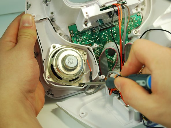

  19. Memorex Mi3X Minimove Speakers Replacement: crwdns2935265:019crwdnd2935265:01crwdnd2935265:02crwdne2935265:0 Memorex Mi3X Minimove Speakers Replacement: crwdns2935265:019crwdnd2935265:02crwdnd2935265:02crwdne2935265:0
    • Unscrew the three 8 mm circled screws that are holding the speaker to the plastic casing.
  20. Memorex Mi3X Minimove Speakers Replacement: crwdns2935265:020crwdnd2935265:01crwdnd2935265:01crwdne2935265:0
    • The speaker is still attached to the speaker board in the boombox. Do not attempt to move the speaker too far away from the boombox.
    • Remove the speaker from the housing and place it next to the boombox.
  21. Memorex Mi3X Minimove Speakers Replacement: crwdns2935265:021crwdnd2935265:01crwdnd2935265:02crwdne2935265:0 Memorex Mi3X Minimove Speakers Replacement: crwdns2935265:021crwdnd2935265:02crwdnd2935265:02crwdne2935265:0
    • The upper wire connector, marked in red, connects the left speaker to the boombox. The lower wire connector, marked in orange, connects the right speaker to boombox.
    • Do not remove the wire connector from the speaker daughter board by pulling on the wire. This may damage the wire and the board.
    • Use your hands to grip the plastic wire housing and detach the upper speaker wire connector from the speaker daughterboard.
