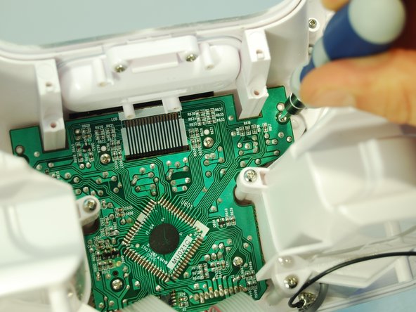

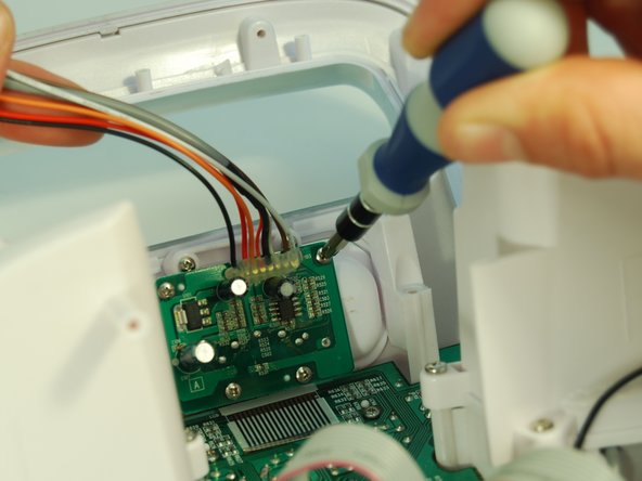

  18. Memorex Mi3X Minimove Display Replacement, Display: crwdns2935265:018crwdnd2935265:01crwdnd2935265:02crwdne2935265:0 Memorex Mi3X Minimove Display Replacement, Display: crwdns2935265:018crwdnd2935265:02crwdnd2935265:02crwdne2935265:0

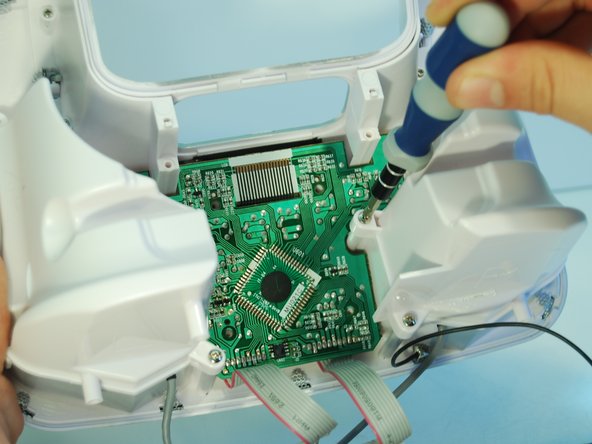

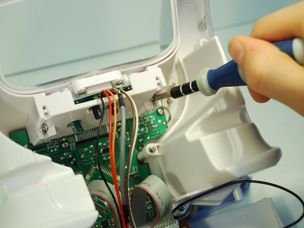

    • Locate and unscrew the four 8mm screws (in red) along the edge with a Phillips #1 screwdriver.
    • Unscrew the two 12mm screws (in orange) on the inside of the daughterboard.
  19. Memorex Mi3X Minimove Display Replacement: crwdns2935265:019crwdnd2935265:01crwdnd2935265:01crwdne2935265:0
    • Slide out the iPod adapter housing by applying moderate pressure with your two index fingers from the inside as well as your thumb downward.

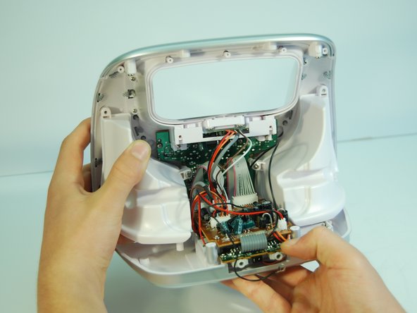

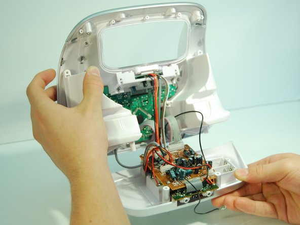

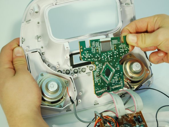

  22. Memorex Mi3X Minimove Display Replacement: crwdns2935265:022crwdnd2935265:01crwdnd2935265:02crwdne2935265:0 Memorex Mi3X Minimove Display Replacement: crwdns2935265:022crwdnd2935265:02crwdnd2935265:02crwdne2935265:0
    • Be careful when removing the daughterboard. There are still two wires connecting the display daughterboard to the radio motherboard which can be damaged or ripped if recklessly removed.
    • Gently lift the display daughterboard straight up and remove it from the case.

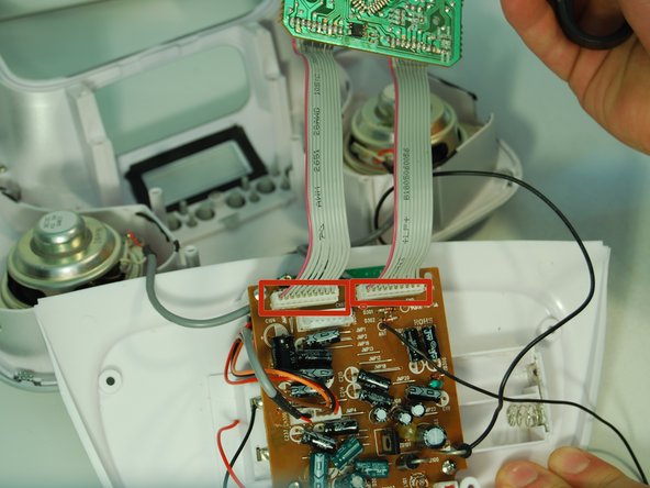

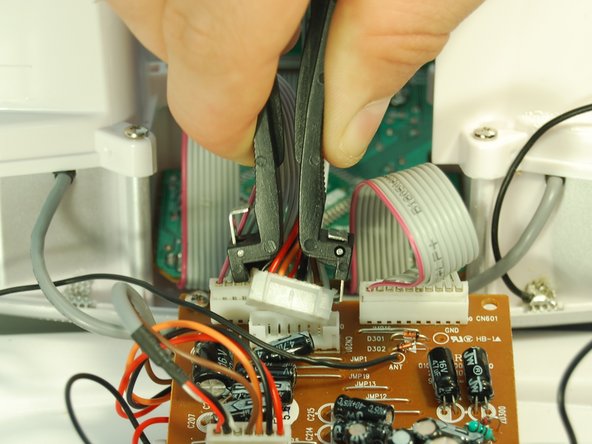

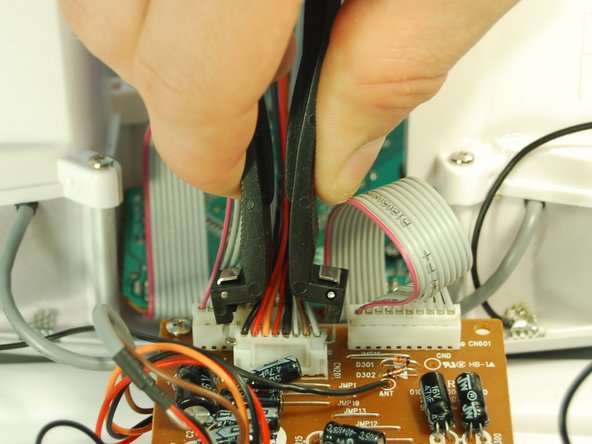

  23. Memorex Mi3X Minimove Display Replacement: crwdns2935265:023crwdnd2935265:01crwdnd2935265:02crwdne2935265:0 Memorex Mi3X Minimove Display Replacement: crwdns2935265:023crwdnd2935265:02crwdnd2935265:02crwdne2935265:0
    • To finish, disconnect the two wires outlined in red rectangles that are connected to the motherboard using the IC extractor.
    • Pinch the IC extractor just under the top lip of the wire housing and pull firmly out.
