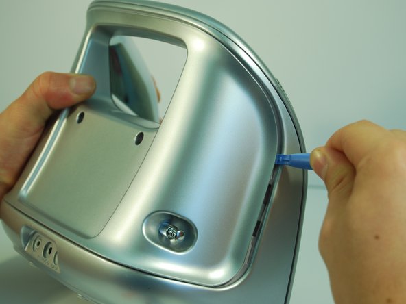

  5. Memorex Mi3X Minimove Back Panel: crwdns2935265:05crwdnd2935265:01crwdnd2935265:02crwdne2935265:0 Memorex Mi3X Minimove Back Panel: crwdns2935265:05crwdnd2935265:02crwdnd2935265:02crwdne2935265:0
    • To remove the back panel, use the plastic opening tool and gently work around the outline of the panel. The outline wraps around the sides and can be spotted at the top back of the device.
  6. Memorex Mi3X Minimove Back Panel: crwdns2935265:06crwdnd2935265:01crwdnd2935265:03crwdne2935265:0 Memorex Mi3X Minimove Back Panel: crwdns2935265:06crwdnd2935265:02crwdnd2935265:03crwdne2935265:0 Memorex Mi3X Minimove Back Panel: crwdns2935265:06crwdnd2935265:03crwdnd2935265:03crwdne2935265:0
    • Be careful not to use too much force to remove the panel. The antenna wire is connected to the inside of the panel and may be damaged or ripped off if the panel is not gently removed.
    • After loosening the panel with the plastic opening tool, use moderate force to pry open the panel with your hands.
    • Carefully pull the panel off.
