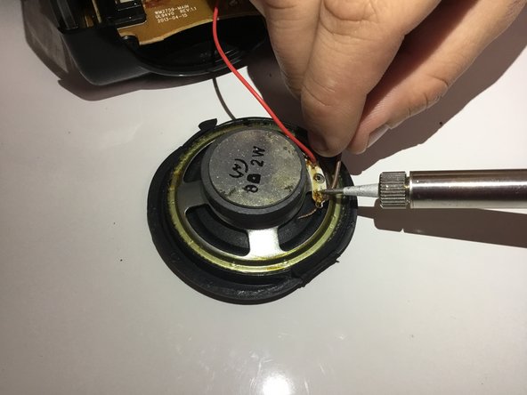

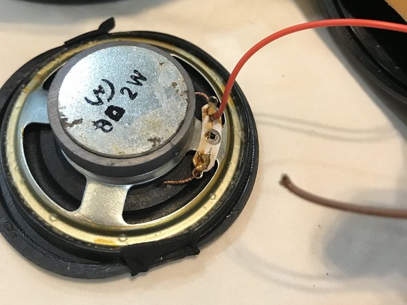

  3. Memorex CD Alarm Clock Radio Speakers Replacement, Speakers: crwdns2935265:03crwdnd2935265:01crwdnd2935265:02crwdne2935265:0 Memorex CD Alarm Clock Radio Speakers Replacement, Speakers: crwdns2935265:03crwdnd2935265:02crwdnd2935265:02crwdne2935265:0
    • Speaker will come out with a firm tug from its seated position.
    • Remove speaker from alarm clock.
  4. Memorex CD Alarm Clock Radio Speakers Replacement: crwdns2935265:04crwdnd2935265:01crwdnd2935265:02crwdne2935265:0 Memorex CD Alarm Clock Radio Speakers Replacement: crwdns2935265:04crwdnd2935265:02crwdnd2935265:02crwdne2935265:0
    • Soldering will be required to install the wires to your new speaker.
