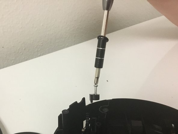

  3. Memorex CD Alarm Clock Radio CD Lid Spring Replacement, CD Lid Spring: crwdns2935265:03crwdnd2935265:01crwdnd2935265:02crwdne2935265:0 Memorex CD Alarm Clock Radio CD Lid Spring Replacement, CD Lid Spring: crwdns2935265:03crwdnd2935265:02crwdnd2935265:02crwdne2935265:0
    • Locate the spring and the spring's retaining piece.
    • There will be a screw that holds the retaining piece in place.
    • Use a screwdriver to remove the screw and the retaining piece.

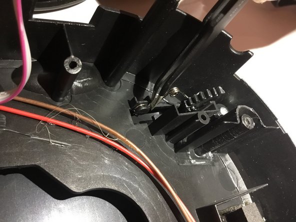

  4. Memorex CD Alarm Clock Radio CD Lid Spring Replacement: crwdns2935265:04crwdnd2935265:01crwdnd2935265:02crwdne2935265:0 Memorex CD Alarm Clock Radio CD Lid Spring Replacement: crwdns2935265:04crwdnd2935265:02crwdnd2935265:02crwdne2935265:0
    • Grasp and remove the spring using tweezers.
