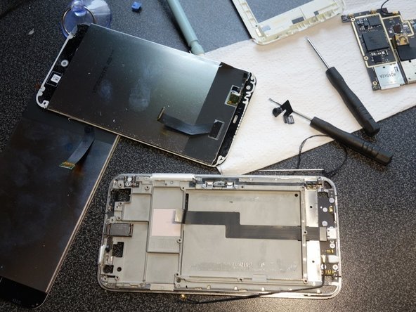

    • Remove the back panel, and unscrew everything to remove the second back panel. Some screw are longer than other. But I mixed them without issue. Here I saw the solution for the network issue: the little contacts between motherboard and screen were bended.
    • I removed the battery, but I think it's not mandatory. If you do, be careful, it's very well glued, and there is some wires behind.
  2. Meizu MX3 Screen Replacement: crwdns2935265:02crwdnd2935265:01crwdnd2935265:01crwdne2935265:0
    • Unplug all the connectors to the motherboard, included the two antennas The small flat ribbon in the corner is a little tricky, you have to switch the black part of the connector, not the white one like some other similar I saw before.
  3. Meizu MX3 Screen Replacement: crwdns2935265:03crwdnd2935265:01crwdnd2935265:01crwdne2935265:0
    • Remove the jack connector, removes the lasts screws (mark the placement for later)
    • Remove the motherboard, starting by the upper part: There is a last connector to unplug at the bottom, behind.
  4. Meizu MX3 Screen Replacement: crwdns2935265:04crwdnd2935265:01crwdnd2935265:02crwdne2935265:0 Meizu MX3 Screen Replacement: crwdns2935265:04crwdnd2935265:02crwdnd2935265:02crwdne2935265:0
    • Now, remove the old screen. It's glued, try to lift a corner, then with a plastic tool, unglue everything.
    • Clean the glue inside the metal part.
  5. Meizu MX3 Screen Replacement: crwdns2935265:05crwdnd2935265:01crwdnd2935265:01crwdne2935265:0
    • Put some adhesive (or some glue?) I used thin double-sided tape I had cut the right shape. the side of the screen are less than 1mm wide, it's hard to do here...
    • Put the screen in the frame, and put everything back in place.
    • Voila!
