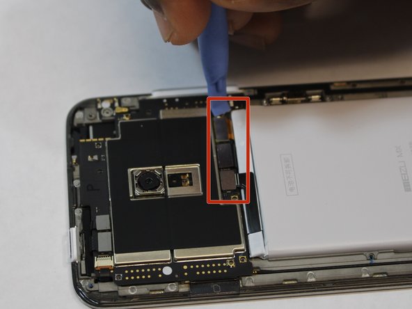

    3. Meizu MX3 Rear Facing Camera Replacement, Removing the Battery: crwdns2935265:03crwdnd2935265:01crwdnd2935265:03crwdne2935265:0 Meizu MX3 Rear Facing Camera Replacement, Removing the Battery: crwdns2935265:03crwdnd2935265:02crwdnd2935265:03crwdne2935265:0 Meizu MX3 Rear Facing Camera Replacement, Removing the Battery: crwdns2935265:03crwdnd2935265:03crwdnd2935265:03crwdne2935265:0

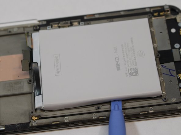

      • After the 11 screws are loosened use the plastic opening tool and gently pry the protective plate from the back of the device.
      • Once the plate is off, use the same tool to gently remove the 3 ribbon cables located directly above the battery.
      • Potential for device damage: On the left side of the battery on the phone case, there is a groove where the plastic opening tool can be inserted to pry the battery up and out. The battery might be glued to the phone so exercise caution.

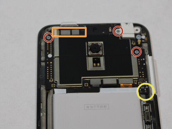

      • Remove the screws in the three red circles.
      • Two of the three ribbon cables in the orange box will need to be removed like those above the battery. Use the pointed edge spudger to pull the third cable out to the left.

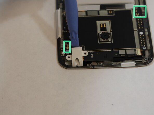

      • Insert the plastic opening tool on top the ribbon cable but below the circuit board in the yellow circle, and pry that ribbon cable free. Remove the headphone jack as see in the picture.

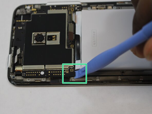

      • Use tweezers to disconnect the wire connector in the green box. As seen in the picture gentle insert the plastic opening tool and unhook that cable and begin to lift the circuit board.

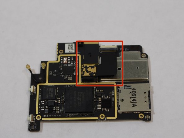

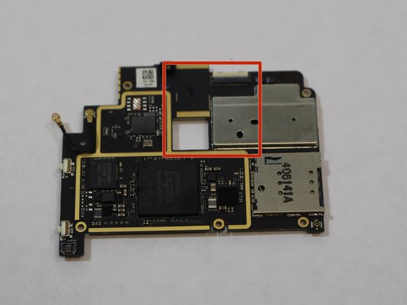

      • Use the pointed edge spudger, remove the cable in the box by prying the left side and right side of the cable repeatedly. Then remove the camera.
      • Once the camera is removed, the circuit board should look like the board in the last picture.
