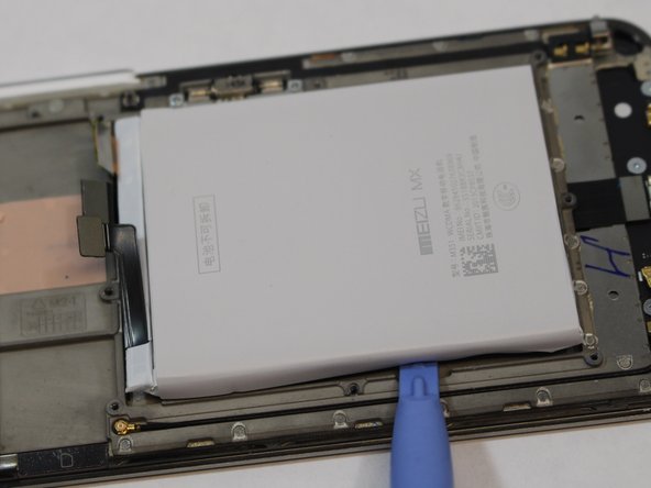

  3. Meizu MX3 Headphone Jack Replacement, Removing the Battery: crwdns2935265:03crwdnd2935265:01crwdnd2935265:03crwdne2935265:0 Meizu MX3 Headphone Jack Replacement, Removing the Battery: crwdns2935265:03crwdnd2935265:02crwdnd2935265:03crwdne2935265:0 Meizu MX3 Headphone Jack Replacement, Removing the Battery: crwdns2935265:03crwdnd2935265:03crwdnd2935265:03crwdne2935265:0
    • After the 11 screws are loosened use the plastic opening tool and gently pry the protective plate from the back of the device.

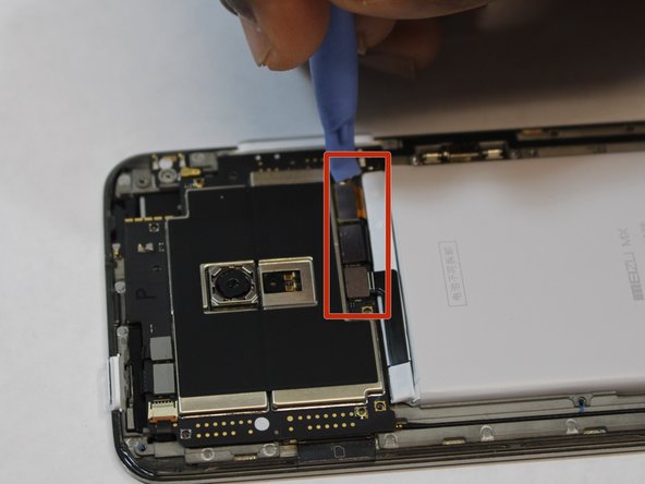

    • Once the plate is off, use the same tool to gently remove the 3 ribbon cables located directly above the battery.
    • On the left side of the battery on the phone case, there is a groove where the plastic opening tool can be inserted to pry the battery up and out. The battery might be glued to the phone so exercise caution.

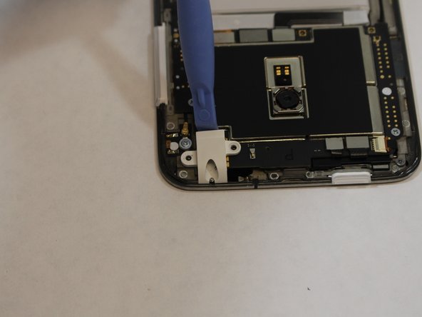

  4. Meizu MX3 Headphone Jack Replacement, Removing the Headphone Jack: crwdns2935265:04crwdnd2935265:01crwdnd2935265:02crwdne2935265:0 Meizu MX3 Headphone Jack Replacement, Removing the Headphone Jack: crwdns2935265:04crwdnd2935265:02crwdnd2935265:02crwdne2935265:0
    • To finish removing the headphone jack the screw in the purple circle fastening the headphone jack to the motherboard will need to be removed.
    • Once slackened, the headphone jack can be pried up using the plastic opening tool, as seen in the picture.
