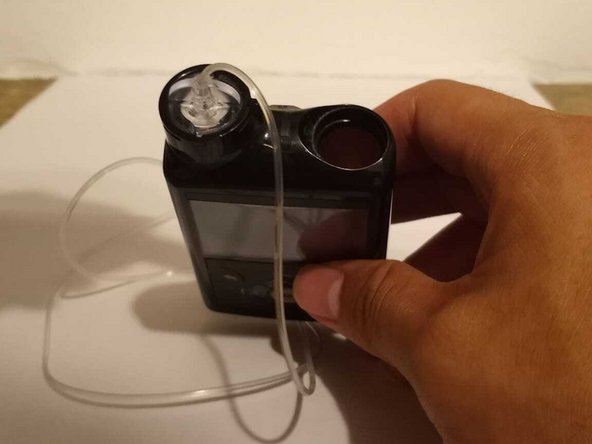

    • Detach the clip on the back of the device.

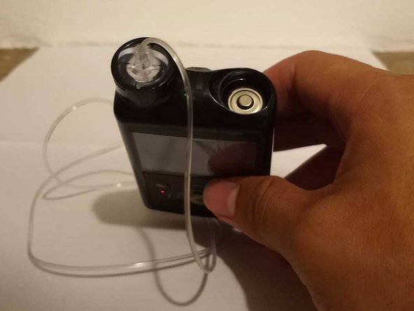

  2. Medtronic 670G Battery Replacement: crwdns2935265:02crwdnd2935265:01crwdnd2935265:03crwdne2935265:0 Medtronic 670G Battery Replacement: crwdns2935265:02crwdnd2935265:02crwdnd2935265:03crwdne2935265:0 Medtronic 670G Battery Replacement: crwdns2935265:02crwdnd2935265:03crwdnd2935265:03crwdne2935265:0
    • Place the small protrusion on the bottom of the clip into the slot on top of the battery housing, and turn it counter clockwise.

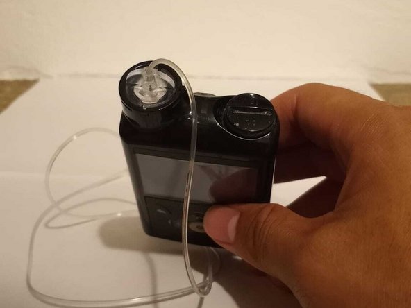

  3. Medtronic 670G Battery Replacement: crwdns2935265:03crwdnd2935265:01crwdnd2935265:03crwdne2935265:0 Medtronic 670G Battery Replacement: crwdns2935265:03crwdnd2935265:02crwdnd2935265:03crwdne2935265:0 Medtronic 670G Battery Replacement: crwdns2935265:03crwdnd2935265:03crwdnd2935265:03crwdne2935265:0
    • Remove the battery cap.
    • Dispose of the old battery according to your state guidelines.

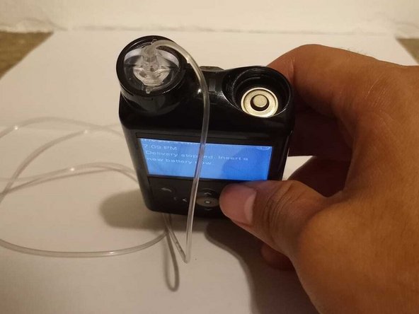

  4. Medtronic 670G Battery Replacement: crwdns2935265:04crwdnd2935265:01crwdnd2935265:02crwdne2935265:0 Medtronic 670G Battery Replacement: crwdns2935265:04crwdnd2935265:02crwdnd2935265:02crwdne2935265:0
    • Insert the new battery, making sure the negative end (the flat part of the battery) is facing down.

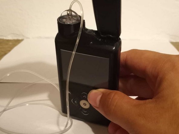

  5. Medtronic 670G Battery Replacement: crwdns2935265:05crwdnd2935265:01crwdnd2935265:03crwdne2935265:0 Medtronic 670G Battery Replacement: crwdns2935265:05crwdnd2935265:02crwdnd2935265:03crwdne2935265:0 Medtronic 670G Battery Replacement: crwdns2935265:05crwdnd2935265:03crwdnd2935265:03crwdne2935265:0
    • Replace the battery cap tighten until it is aligned.
    • Do not over-tighten the cap as it will make it extremely difficult to unscrew next time.
