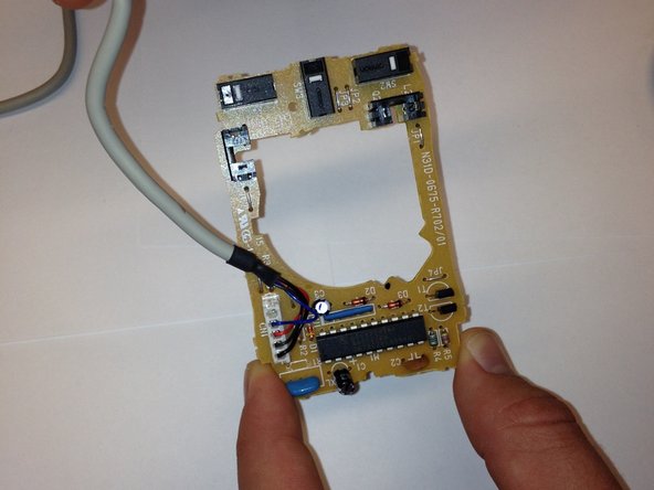

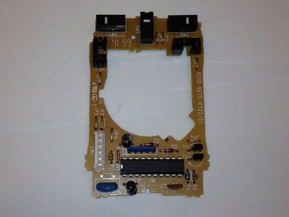

  4. Mechanical Mouse Teardown: crwdns2935265:04crwdnd2935265:01crwdnd2935265:03crwdne2935265:0 Mechanical Mouse Teardown: crwdns2935265:04crwdnd2935265:02crwdnd2935265:03crwdne2935265:0 Mechanical Mouse Teardown: crwdns2935265:04crwdnd2935265:03crwdnd2935265:03crwdne2935265:0
    • Remove the wire from the plastic casing near the top of the mouse.
    • Lift up to remove the PCB which is attached to the mouse.
    • Place case to the side.

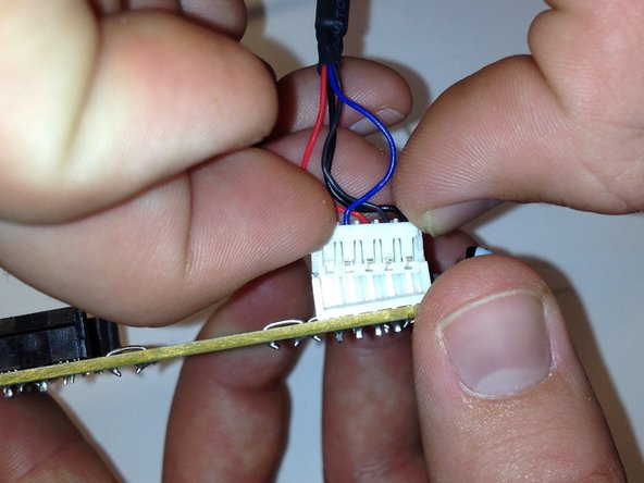

  5. Mechanical Mouse Teardown: crwdns2935265:05crwdnd2935265:01crwdnd2935265:03crwdne2935265:0 Mechanical Mouse Teardown: crwdns2935265:05crwdnd2935265:02crwdnd2935265:03crwdne2935265:0 Mechanical Mouse Teardown: crwdns2935265:05crwdnd2935265:03crwdnd2935265:03crwdne2935265:0
    • Locate where the wire is connected to the PCB via the white connection.
    • Pry the connections apart and place the cable to the side.
