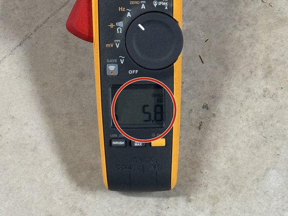

Measuring Current with Clamp Meter and AC Line Splitter

    • Connect AC Line Splitter to power Source.
    • Connect device to test to AC line splitter.
    • On Multimeter, select AC Current.
  2. Measuring Current with Clamp Meter and AC Line Splitter: crwdns2935265:02crwdnd2935265:01crwdnd2935265:02crwdne2935265:0 Measuring Current with Clamp Meter and AC Line Splitter: crwdns2935265:02crwdnd2935265:02crwdnd2935265:02crwdne2935265:0
    • Clamp meter on the x1 loop of the line splitter for most devices. Only use the x10 loop if you are testing a very low current device.
    • Turn on the device you are testing.
    • Read the current indicated on your meter.
    • You are done with this procedure. Turn off the device you are testing and disconnect your equipment.
Using this process can allow you to measure how much current a device is drawing which can aid in troubleshooting. A device drawing more than it's rated amount of current can be an indication of a problem.
