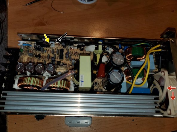

    • There's 8 screws, 3 on each side and 2 on top. You need to remove to open the PSU. 1 of them is under the yellow sticker.
    • Slide the cover off.
  2. Meanwell SE-600-24 Fan Replacement, Disassembly: crwdns2935265:02crwdnd2935265:01crwdnd2935265:01crwdne2935265:0
    • Remove the 5 screws that hold the board in to the case, than remove the board.

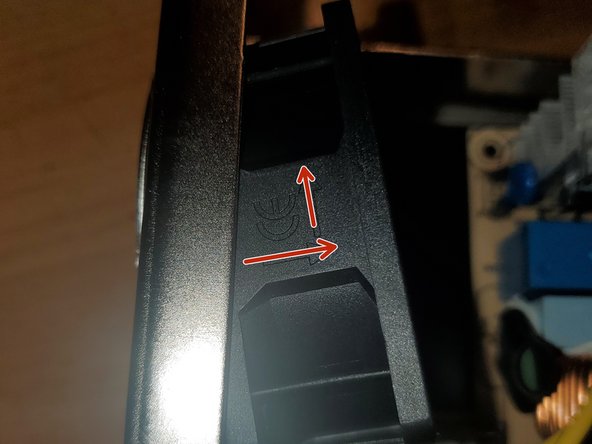

  3. Meanwell SE-600-24 Fan Replacement, Disassembly: crwdns2935265:03crwdnd2935265:01crwdnd2935265:02crwdne2935265:0 Meanwell SE-600-24 Fan Replacement, Disassembly: crwdns2935265:03crwdnd2935265:02crwdnd2935265:02crwdne2935265:0
    • Remove the 2 screws securing the fan to the casing.
    • Remove the fan.
    • Note the airflow arrows. When we put the new fan in we want to make sure the fan directs the air correctly.

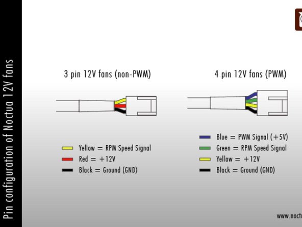

  4. Meanwell SE-600-24 Fan Replacement, Wiring/Reassembly: crwdns2935265:04crwdnd2935265:01crwdnd2935265:03crwdne2935265:0 Meanwell SE-600-24 Fan Replacement, Wiring/Reassembly: crwdns2935265:04crwdnd2935265:02crwdnd2935265:03crwdne2935265:0 Meanwell SE-600-24 Fan Replacement, Wiring/Reassembly: crwdns2935265:04crwdnd2935265:03crwdnd2935265:03crwdne2935265:0
    • The NF-A6x25 is a 4 wire PWM fan. Since we don't need all 4 wires cut the harness to length(12" should be enough).
    • Crimp on some JST 2.54 connectors.
    • 4 Pin fan: Yellow is 12v and Black is Ground
    • 3 Pin fan: Red is 12v and Black is ground
    • Mount the NF-A6x25 were the original fan was with the 2 screws that held in the Sunon fan. Make sure the airflow arrows point towards the board.
    • Insert the board into the case and secure it with the 5 screws.
    • Connect the NF-A6x25 fan to the board. Positive on the left and Negative on the right
    • Slide the casing cover on and the remaining 6 screws
