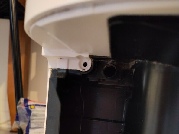

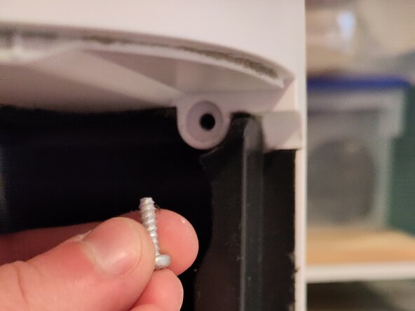

  1. Meaco Arete One Display Replacement, Remove external screws: crwdns2935265:01crwdnd2935265:01crwdnd2935265:03crwdne2935265:0 Meaco Arete One Display Replacement, Remove external screws: crwdns2935265:01crwdnd2935265:02crwdnd2935265:03crwdne2935265:0 Meaco Arete One Display Replacement, Remove external screws: crwdns2935265:01crwdnd2935265:03crwdnd2935265:03crwdne2935265:0
    • 4x in the vent
    • 4x after removing the water tank (2 at the top and 2 at the bottom (bottom screws not pictured)

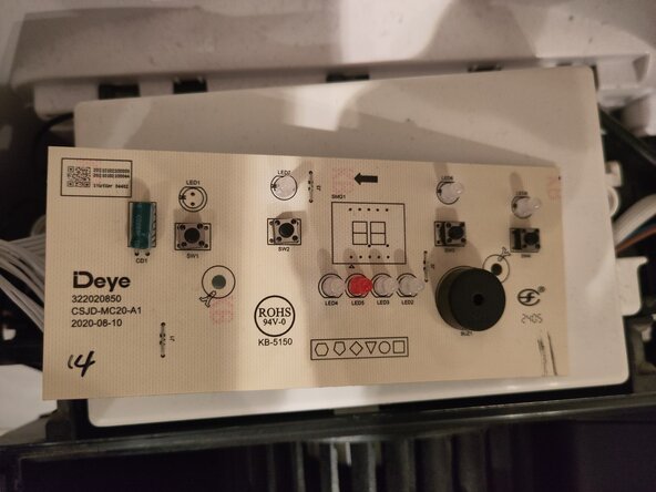

  5. Meaco Arete One Display Replacement, Detach display circuit board: crwdns2935265:06crwdnd2935265:01crwdnd2935265:01crwdne2935265:0
    • Detach the two connectors by squeezing the clamps and pulling them off.
    • The whole top of the unit should now be completely detached
    • Unscrew the two Phillips screws holding the circuit board to the cover
    • Carefully unclip the circuit board

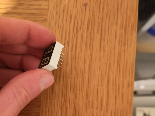

  6. Meaco Arete One Display Replacement, Desolder the 2 digit 7 segment display: crwdns2935265:07crwdnd2935265:01crwdnd2935265:03crwdne2935265:0 Meaco Arete One Display Replacement, Desolder the 2 digit 7 segment display: crwdns2935265:07crwdnd2935265:02crwdnd2935265:03crwdne2935265:0 Meaco Arete One Display Replacement, Desolder the 2 digit 7 segment display: crwdns2935265:07crwdnd2935265:03crwdnd2935265:03crwdne2935265:0
    • The highlighted 10 pins hold the display on
    • Once you've desoldered the pins, use a pair of pliers to grip the 2 digit display and pull it off the circuit board
    • If you connect the circuit board carefully and try to only touch the power button you can see if the device works - it should be working without a screen.
    • There are many replacement screens available. You need to find a common cathode two digit (sometimes called two bit) 7 segment 0.4 inch display with white LEDs (LED colour is probably not important)
    • 0.4 inches refers to the short edge of the display
    • I found this one: https://www.aliexpress.com/item/10050085...
    • Which is ~£1 for 5 of them
    • Make sure it's got 10 pins - 5 on each side
