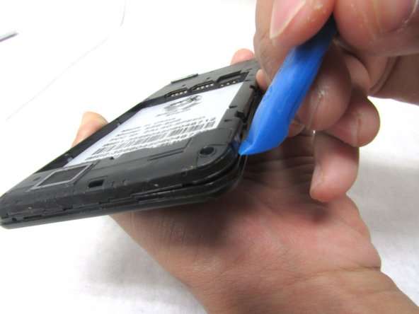

    • With the phone face down, remove the back cover with the plastic opening tool. For easiest access, insert the plastic opening tool in the bottom left corner.

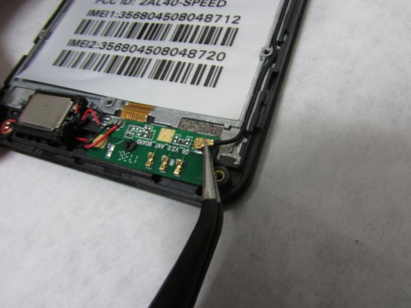

  4. Maze Speed SSB-508 Speaker and Microphone Replacement: crwdns2935265:04crwdnd2935265:01crwdnd2935265:02crwdne2935265:0 Maze Speed SSB-508 Speaker and Microphone Replacement: crwdns2935265:04crwdnd2935265:02crwdnd2935265:02crwdne2935265:0
    • Locate the wire that attaches the motherboard to the daughter-board of the speaker and mic. Using tweezers, disconnect the wire from the motherboard.

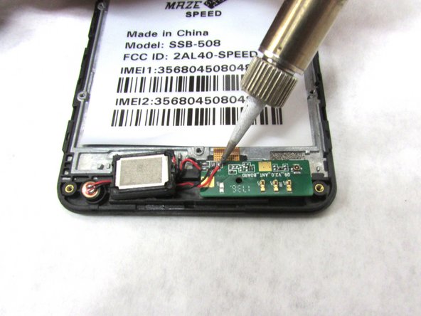

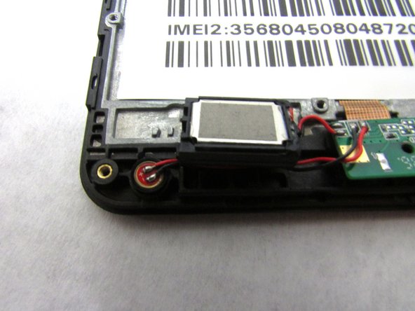

  5. Maze Speed SSB-508 Speaker and Microphone Replacement: crwdns2935265:05crwdnd2935265:01crwdnd2935265:03crwdne2935265:0 Maze Speed SSB-508 Speaker and Microphone Replacement: crwdns2935265:05crwdnd2935265:02crwdnd2935265:03crwdne2935265:0 Maze Speed SSB-508 Speaker and Microphone Replacement: crwdns2935265:05crwdnd2935265:03crwdnd2935265:03crwdne2935265:0
    • Using your soldering tools, un-solder both set of wires that are connected to the daughter-board.
    • You may now replace the old speaker and mic with new accessories.
