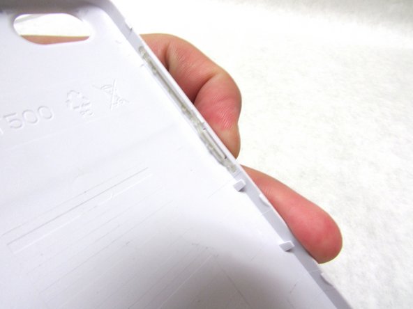

    • Remove the back cover by gently prying open the bottom left corner of the case with the plastic opening tool.

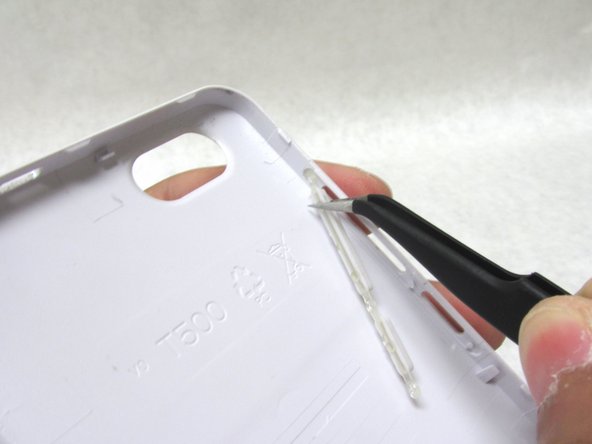

    • There are three areas holding the power and volume buttons in place. Gently pull the bottom of the power button with a pair of fine-tip tweezers to release the lower half.
  3. Maze Speed SSB-508 Power and Volume Button Replacement: crwdns2935265:03crwdnd2935265:01crwdnd2935265:03crwdne2935265:0 Maze Speed SSB-508 Power and Volume Button Replacement: crwdns2935265:03crwdnd2935265:02crwdnd2935265:03crwdne2935265:0 Maze Speed SSB-508 Power and Volume Button Replacement: crwdns2935265:03crwdnd2935265:03crwdnd2935265:03crwdne2935265:0
    • Carefully remove the top section of the button with the fine-tip tweezers . This should free the button completely.
