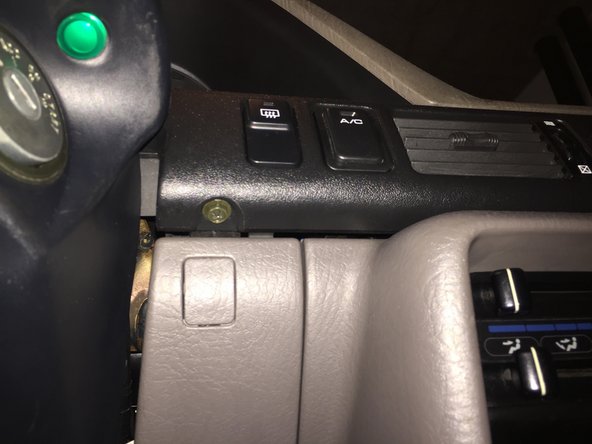

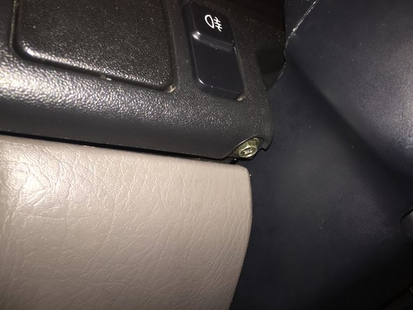

    • Remove the 3 screws holding the cover in place.
  4. Mazda 323 BG Dashboard Replacement: crwdns2935265:04crwdnd2935265:01crwdnd2935265:01crwdne2935265:0
    • Remove the 2 screws above of the Dashboard.

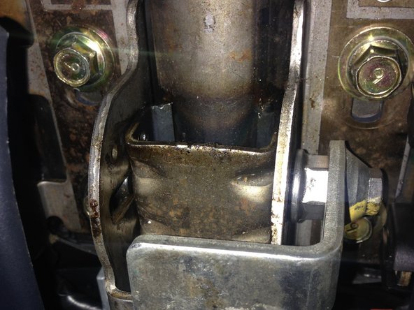

    • Option 2: Without height adjustable steering column: Remove all 4 screws of the steering column trim. Afterwards: remove the large golden screws. Be carefull whilst removing the last one: hold the column tight with one hand or it will fall, since it is screwed to nothing else.
