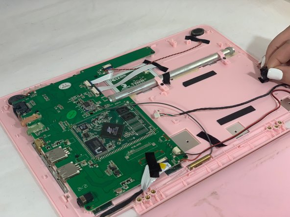

      • Using two plastic opening tools, pry off the bottom of the netbook by going around the edges.
    5. Maylong MN-1000P Screen Replacement: crwdns2935265:05crwdnd2935265:01crwdnd2935265:01crwdne2935265:0
      • Remove the bottom of the netbook by lifting the corners.

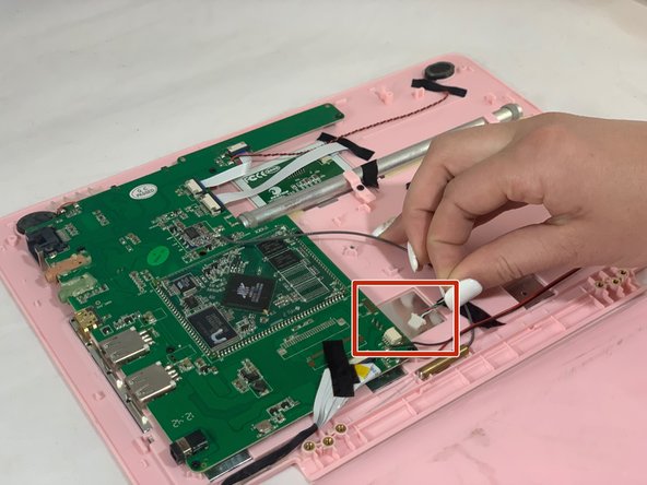

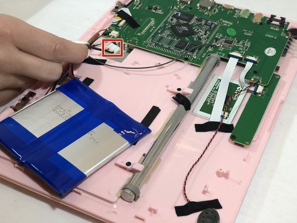

    1. Maylong MN-1000P Screen Replacement, Battery: crwdns2935265:06crwdnd2935265:01crwdnd2935265:02crwdne2935265:0 Maylong MN-1000P Screen Replacement, Battery: crwdns2935265:06crwdnd2935265:02crwdnd2935265:02crwdne2935265:0
      • Pinch the red and black wires connected to the section closest to the small white connector, and pull to remove them from the motherboard.

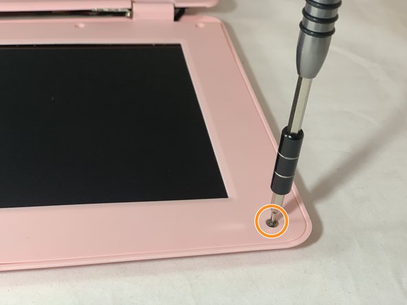

    1. Maylong MN-1000P Screen Replacement, Screen: crwdns2935265:07crwdnd2935265:01crwdnd2935265:01crwdne2935265:0
      • Remove the six 6mm Phillips #00 screws from both sides of the netbook.

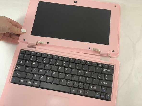

    2. Maylong MN-1000P Screen Replacement: crwdns2935265:08crwdnd2935265:01crwdnd2935265:02crwdne2935265:0 Maylong MN-1000P Screen Replacement: crwdns2935265:08crwdnd2935265:02crwdnd2935265:02crwdne2935265:0
      • Pull the top of the computer and the back side of the computer away from each other until they are detached.
      • Flip the entire computer over so you can see both the screen and keyboard.

    4. Maylong MN-1000P Screen Replacement: crwdns2935265:010crwdnd2935265:01crwdnd2935265:01crwdne2935265:0
      • Using a plastic opening tool, pry off the screen bezel.
      • After detaching the screen bezel, pull up on the bezel near the hinge area.

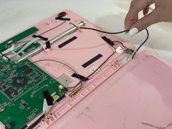

    5. Maylong MN-1000P Screen Replacement: crwdns2935265:011crwdnd2935265:01crwdnd2935265:01crwdne2935265:0
      • Use tweezers to gently pull on the black and white wires at the top of the netbook until the white connector detaches.
    6. Maylong MN-1000P Screen Replacement: crwdns2935265:012crwdnd2935265:01crwdnd2935265:01crwdne2935265:0
      • Use your fingers to pull on the green, red, black, and white intertwined wires at the bottom of the netbook until the white connector detaches.

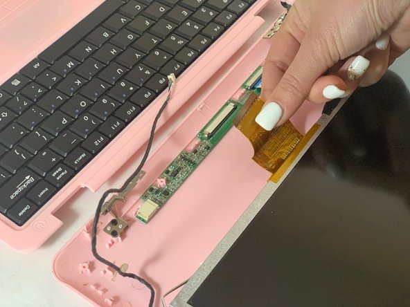

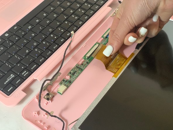

    7. Maylong MN-1000P Screen Replacement: crwdns2935265:013crwdnd2935265:01crwdnd2935265:03crwdne2935265:0 Maylong MN-1000P Screen Replacement: crwdns2935265:013crwdnd2935265:02crwdnd2935265:03crwdne2935265:0 Maylong MN-1000P Screen Replacement: crwdns2935265:013crwdnd2935265:03crwdnd2935265:03crwdne2935265:0
      • Detach the wide yellow ribbon cable connected to the screen from the computer.
    8. Maylong MN-1000P Screen Replacement: crwdns2935265:014crwdnd2935265:01crwdnd2935265:02crwdne2935265:0 Maylong MN-1000P Screen Replacement: crwdns2935265:014crwdnd2935265:02crwdnd2935265:02crwdne2935265:0
      • Flip the computer over.
      • Disconnect the red, green, black, and white intertwined wires from the connector to the motherboard.
    9. Maylong MN-1000P Screen Replacement: crwdns2935265:015crwdnd2935265:01crwdnd2935265:03crwdne2935265:0 Maylong MN-1000P Screen Replacement: crwdns2935265:015crwdnd2935265:02crwdnd2935265:03crwdne2935265:0 Maylong MN-1000P Screen Replacement: crwdns2935265:015crwdnd2935265:03crwdnd2935265:03crwdne2935265:0
      • Remove the black tape holding down the red, green, black, and white intertwined wires.
      • Remove the screen.
