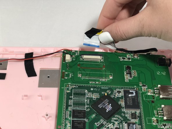

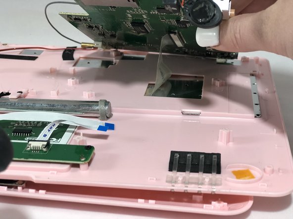

  16. Maylong MN-1000P Button Panel Replacement, Motherboard: crwdns2935265:016crwdnd2935265:01crwdnd2935265:01crwdne2935265:0
    • Remove the six 6mm Phillips #00 screws from the motherboard.
  17. Maylong MN-1000P Button Panel Replacement: crwdns2935265:017crwdnd2935265:01crwdnd2935265:01crwdne2935265:0
    • Remove the two 6mm silver screws from the small circuit board connected to the motherboard by the red and black wires.
  18. Maylong MN-1000P Button Panel Replacement: crwdns2935265:018crwdnd2935265:01crwdnd2935265:01crwdne2935265:0
    • Remove the two small black speakers on the corners connected to the motherboard by the black and red wires.
  19. Maylong MN-1000P Button Panel Replacement: crwdns2935265:019crwdnd2935265:01crwdnd2935265:01crwdne2935265:0
    • Disconnect the black connectors from the motherboard by pulling on the white ribbon cable.
  20. Maylong MN-1000P Button Panel Replacement: crwdns2935265:020crwdnd2935265:01crwdnd2935265:02crwdne2935265:0 Maylong MN-1000P Button Panel Replacement: crwdns2935265:020crwdnd2935265:02crwdnd2935265:02crwdne2935265:0
    • Remove the black covered wire connected to the motherboard by pulling the white ribbon cable away from the motherboard.
  21. Maylong MN-1000P Button Panel Replacement: crwdns2935265:021crwdnd2935265:01crwdnd2935265:01crwdne2935265:0
    • Using a spudger, remove the gold cylinder out of the indent at the bottom of the computer.
  22. Maylong MN-1000P Button Panel Replacement: crwdns2935265:022crwdnd2935265:01crwdnd2935265:02crwdne2935265:0 Maylong MN-1000P Button Panel Replacement: crwdns2935265:022crwdnd2935265:02crwdnd2935265:02crwdne2935265:0
    • Lift the motherboard up.
    • Remove the motherboard by detaching the clear tape from underneath the motherboard.

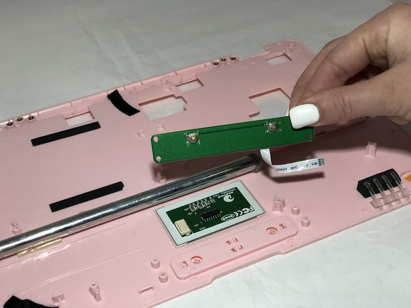

  23. Maylong MN-1000P Button Panel Replacement, Button Panel: crwdns2935265:023crwdnd2935265:01crwdnd2935265:01crwdne2935265:0
    • Remove the four 6mm Phillips #00 screws from the button panel.
  24. Maylong MN-1000P Button Panel Replacement: crwdns2935265:024crwdnd2935265:01crwdnd2935265:02crwdne2935265:0 Maylong MN-1000P Button Panel Replacement: crwdns2935265:024crwdnd2935265:02crwdnd2935265:02crwdne2935265:0
    • Lift up the button panel and replace.
