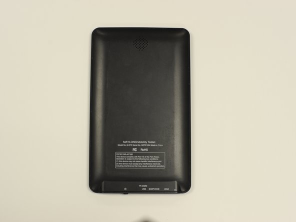

      • Use the plastic opening tool to separate the back cover plate from the front.
      • Insert the plastic opening tool in between the back plate cover and the top cover, then slide along edges to pry open.

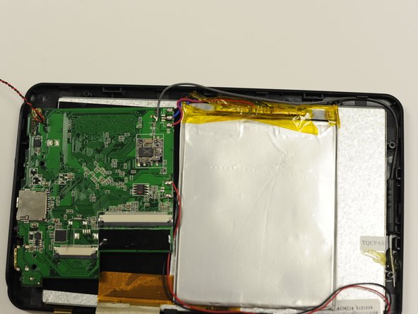

      • Locate the two ribbons attached to the device's motherboard.
      • Flip the small black plastic catches down by using the small end of the spudger.
      • Remove the ribbons by gently pulling them away from the motherboard.
    3. Maylong M-270 Battery Replacement: crwdns2935265:03crwdnd2935265:01crwdnd2935265:02crwdne2935265:0 Maylong M-270 Battery Replacement: crwdns2935265:03crwdnd2935265:02crwdnd2935265:02crwdne2935265:0
      • Remove the two screws from the motherboard.
      • Remove the four screws and metal holds from the edge of the device.

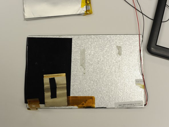

    4. Maylong M-270 Battery Replacement: crwdns2935265:04crwdnd2935265:01crwdnd2935265:01crwdne2935265:0
      • Remove the motherboard by gently pulling it away from the bottom of the device.

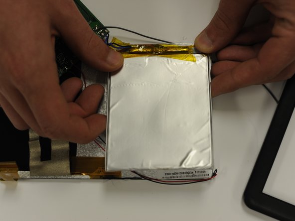

    2. Maylong M-270 Battery Replacement: crwdns2935265:06crwdnd2935265:01crwdnd2935265:03crwdne2935265:0 Maylong M-270 Battery Replacement: crwdns2935265:06crwdnd2935265:02crwdnd2935265:03crwdne2935265:0 Maylong M-270 Battery Replacement: crwdns2935265:06crwdnd2935265:03crwdnd2935265:03crwdne2935265:0
      • Remove the battery by using the spudger to gently pry the battery away from metal case around the front screen.
