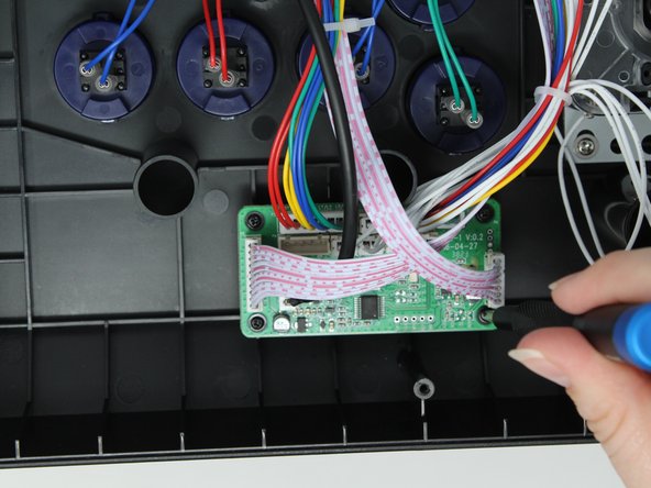

    • Flip the controller upside down so that the metal panel is facing you.
    • Remove the six 11 mm screws securing the metal panel using a Phillips #2 screwdriver.
    • Once all screws are removed, lift off the panel.
  2. Mayflash Arcade Stick F300 USB Cable Replacement, USB Cable: crwdns2935265:02crwdnd2935265:01crwdnd2935265:02crwdne2935265:0 Mayflash Arcade Stick F300 USB Cable Replacement, USB Cable: crwdns2935265:02crwdnd2935265:02crwdnd2935265:02crwdne2935265:0
    • Remove the four 10 mm truss head screws securing the PCB to the plastic outer casing using a Phillips #1 screwdriver.

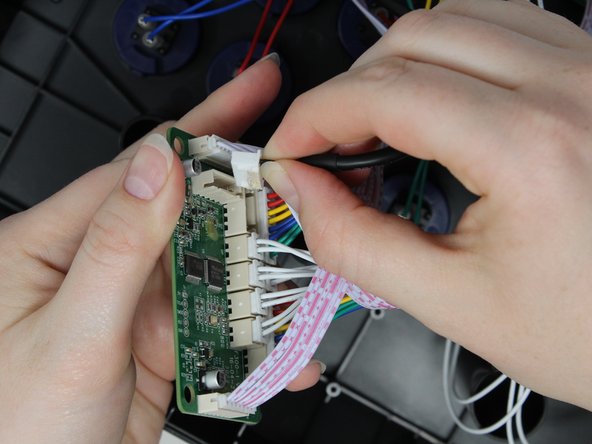

  3. Mayflash Arcade Stick F300 USB Cable Replacement: crwdns2935265:03crwdnd2935265:01crwdnd2935265:03crwdne2935265:0 Mayflash Arcade Stick F300 USB Cable Replacement: crwdns2935265:03crwdnd2935265:02crwdnd2935265:03crwdne2935265:0 Mayflash Arcade Stick F300 USB Cable Replacement: crwdns2935265:03crwdnd2935265:03crwdnd2935265:03crwdne2935265:0
    • Use a hair dryer or heat gun to soften the glue holding the USB cable into the socket on the PCB.
    • It should take less than a minute for the glue to be soft enough to remove. Do not overheat the circuit board.

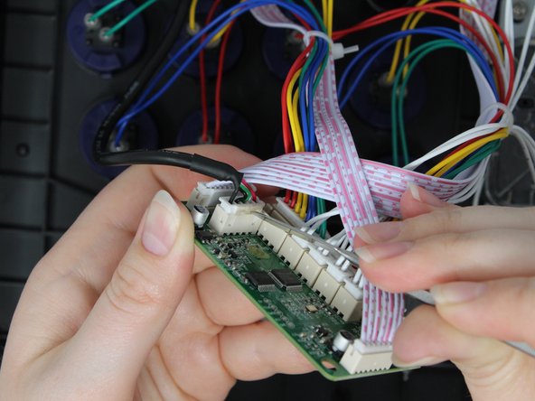

    • Use a metal spudger to gently remove the softened glue.
    • Remove the cable from the socket

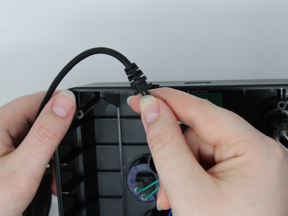

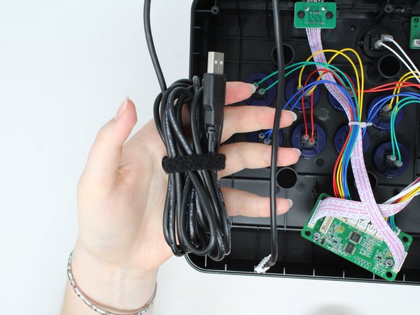

    • Slide the strain relief segment of the USB cable out of the plastic outer casing.
    • Remove the cable.
