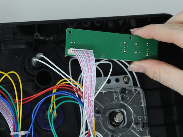

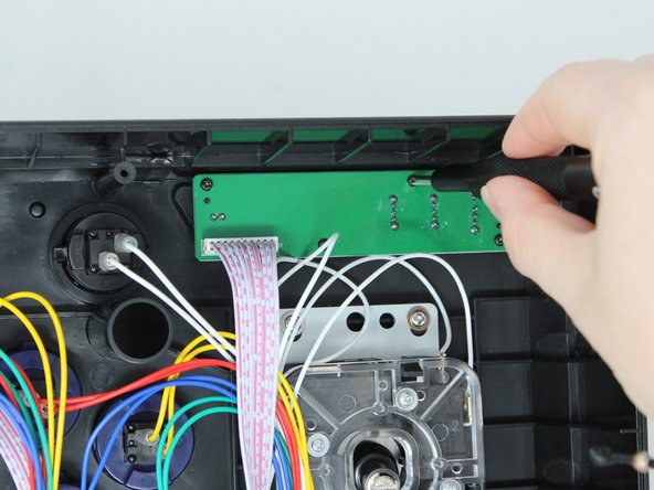

    • Remove the four screws that secure the button board with a Phillips #1 screwdriver.
    • Lift the board out of the outer casing.

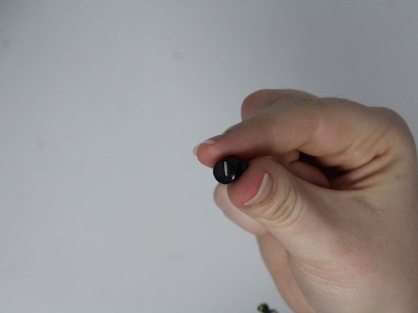

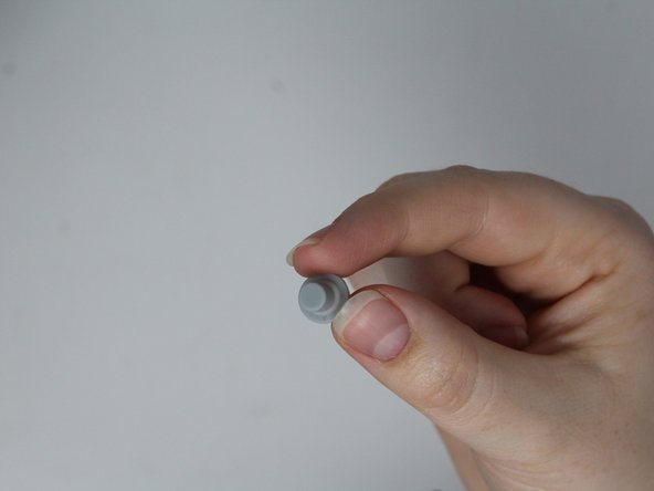

    • Identify the broken button, and replace it.
