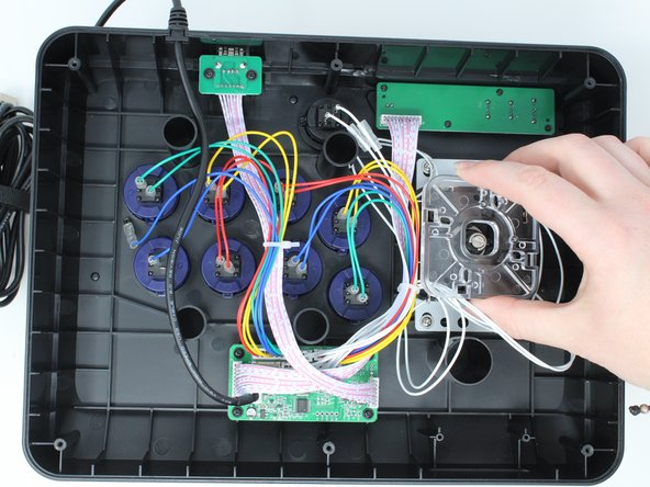

    • Flip the controller upside down so that the metal panel is facing you.
    • Remove the six 11 mm screws securing the metal panel using a Phillips #2 screwdriver.
    • Once all screws are removed, lift off the panel.

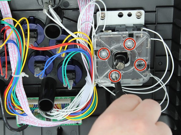

    • Remove the four 9 mm truss head screws fastening the clear plastic square joystick gate to the casing underneath using a Phillips #1 screwdriver.

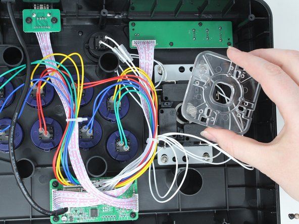

  3. Mayflash Arcade Stick F300 Microswitch Replacement: crwdns2935265:03crwdnd2935265:01crwdnd2935265:03crwdne2935265:0 Mayflash Arcade Stick F300 Microswitch Replacement: crwdns2935265:03crwdnd2935265:02crwdnd2935265:03crwdne2935265:0 Mayflash Arcade Stick F300 Microswitch Replacement: crwdns2935265:03crwdnd2935265:03crwdnd2935265:03crwdne2935265:0
    • Gently push back on each of the four black locking tabs securing the joystick gate to the casing.
    • Remove the joystick gate.

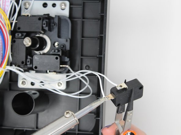

    • Lift the chosen microswitch vertically off the rod holding it in position.
    • Desolder the wire from the terminal (metal connection point).
    • Beware of overheating the soldering kit as it can damage electronic components.
    • Use a wire stripper or small blade to strip the insulation approximately 1 cm from the end of the wire before resoldering to the new part.
