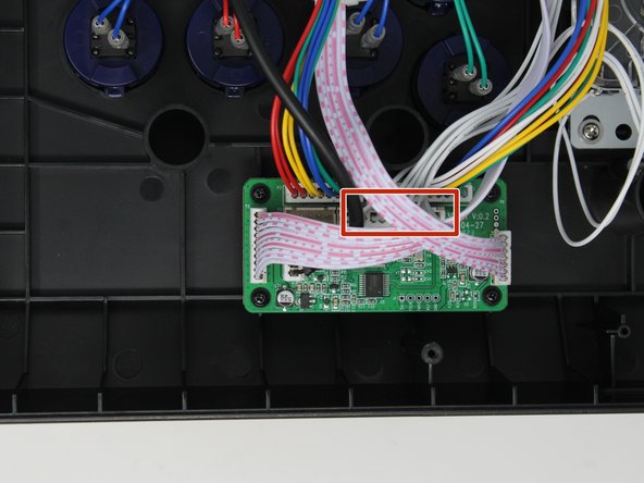

  2. Mayflash Arcade Stick F300 Joystick Replacement, Joystick: crwdns2935265:02crwdnd2935265:01crwdnd2935265:02crwdne2935265:0 Mayflash Arcade Stick F300 Joystick Replacement, Joystick: crwdns2935265:02crwdnd2935265:02crwdnd2935265:02crwdne2935265:0
    • Detach the micro switch cables connected to the PCB (printed circuit board).

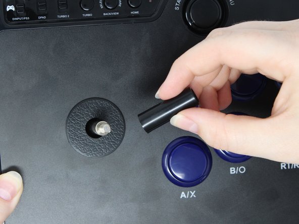

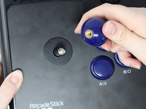

    • Use a flathead screwdriver to hold the bottom screw of the joystick lever in place.
    • Flip the device over.
    • Grab the ball top of the joystick and twist while the screwdriver prevents the screw from turning.
    • Once the ball top is removed, slide off the plastic tube and plate from the joystick.

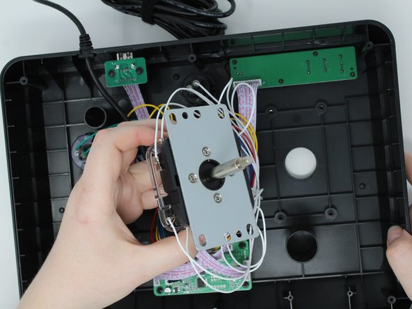

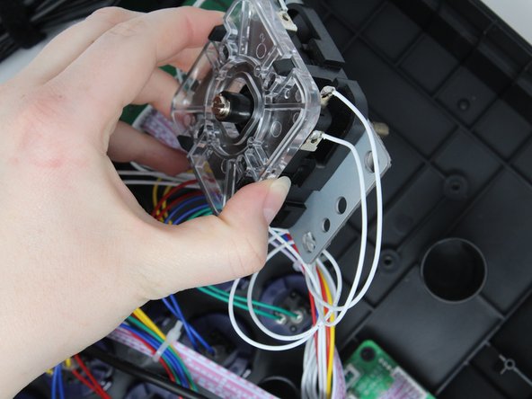

    • Flip the device over again, exposing the inside.
    • Use a Phillips #1 screwdriver to remove the four screws holding down the joystick lever.
    • Slide the joystick out of the outer plastic casing.
