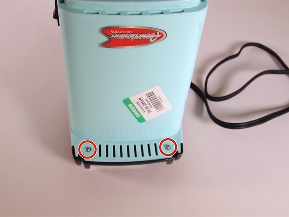

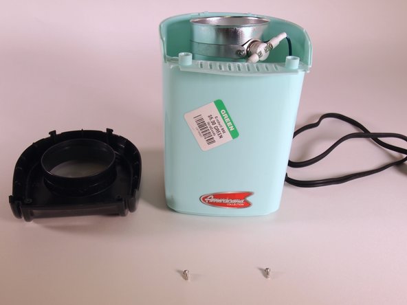

    • Turn the air popper back over (right side up). Remove the plastic protection piece from the top of the air popper.
    • There are two screws on the front connecting the base to the lid, each approximately 9 mm long.
    • Remove the two screws using a #2x4" screwdriver.
    • Remove the black lid.
    • There are latches along the edges that release when the lid is pulled.

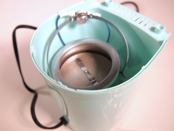

  6. Maxi-Matic Intertek Popcorn Maker Replacement Disassembly Guide: crwdns2935265:06crwdnd2935265:01crwdnd2935265:01crwdne2935265:0
    • Around the edge of the remaining wider, shorter cylinder, there are four screws.
    • The two most easily accessible screws, opposite the blue wires, are approximately 9 mm long.
    • Remove these two screws using a #2x4" screwdriver.

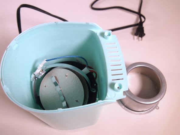

  7. Maxi-Matic Intertek Popcorn Maker Replacement Disassembly Guide: crwdns2935265:07crwdnd2935265:01crwdnd2935265:02crwdne2935265:0 Maxi-Matic Intertek Popcorn Maker Replacement Disassembly Guide: crwdns2935265:07crwdnd2935265:02crwdnd2935265:02crwdne2935265:0
    • Of the remaining two screws near the blue wires, the one on the left is approximately 11 mm long, and the one on the right is approximately 19 mm long.
    • Remove the wide, short cylinder from the interior by pulling and separating it from the disk inside it, taking the cylinder fully out.

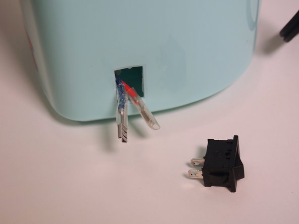

  8. Maxi-Matic Intertek Popcorn Maker Replacement Disassembly Guide: crwdns2935265:08crwdnd2935265:01crwdnd2935265:02crwdne2935265:0 Maxi-Matic Intertek Popcorn Maker Replacement Disassembly Guide: crwdns2935265:08crwdnd2935265:02crwdnd2935265:02crwdne2935265:0
    • Use a plastic iFixit prying tool to remove the switch from the main body.
    • Disconnect the blue and red wires from the switch.

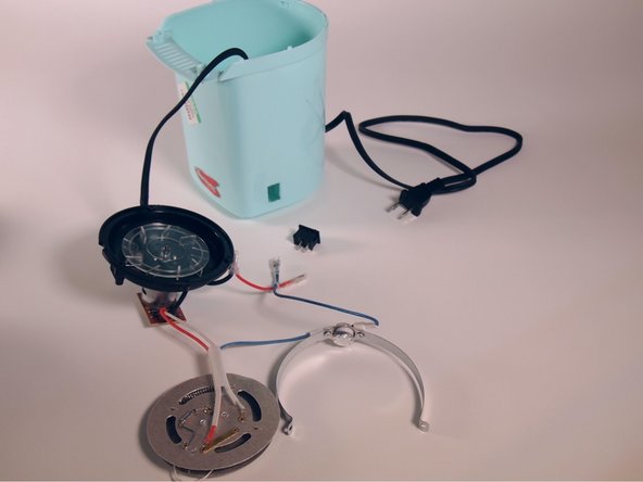

  9. Maxi-Matic Intertek Popcorn Maker Replacement Disassembly Guide: crwdns2935265:09crwdnd2935265:01crwdnd2935265:03crwdne2935265:0 Maxi-Matic Intertek Popcorn Maker Replacement Disassembly Guide: crwdns2935265:09crwdnd2935265:02crwdnd2935265:03crwdne2935265:0 Maxi-Matic Intertek Popcorn Maker Replacement Disassembly Guide: crwdns2935265:09crwdnd2935265:03crwdnd2935265:03crwdne2935265:0

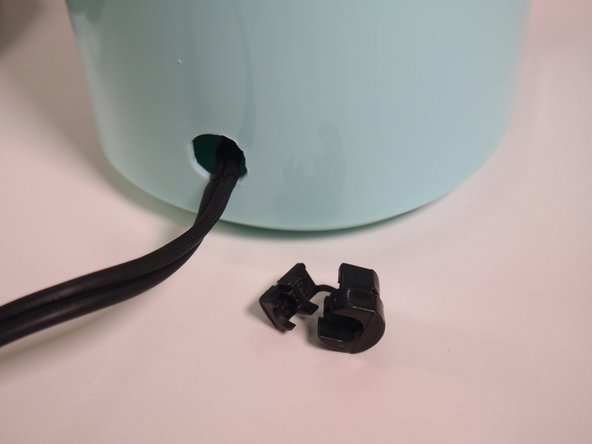

    • Use a plastic iFixit prying tool to remove the cord attachment from the main body of the air popper.
    • Remove the entire circuit from the device.
    • The circuit will come out easily.
