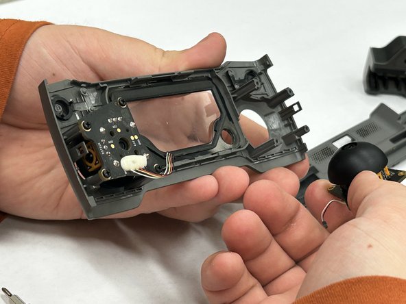

  4. Mavic 2 Controller Joystick Replacement: crwdns2935265:04crwdnd2935265:01crwdnd2935265:02crwdne2935265:0 Mavic 2 Controller Joystick Replacement: crwdns2935265:04crwdnd2935265:02crwdnd2935265:02crwdne2935265:0
    • Now that the top cover is removed flip it over and you will see something similar to picture one.
    • You will need to use the Phillip #0 to remove the four screws holding the joystick to the top cover plate.
    • This will allow you to replace the joystick with a new one.
