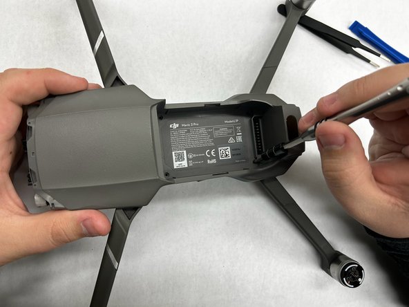

  3. Mavic 2 Arm Replacement: crwdns2935265:03crwdnd2935265:01crwdnd2935265:03crwdne2935265:0 Mavic 2 Arm Replacement: crwdns2935265:03crwdnd2935265:02crwdnd2935265:03crwdne2935265:0 Mavic 2 Arm Replacement: crwdns2935265:03crwdnd2935265:03crwdnd2935265:03crwdne2935265:0
    • Remove the six M2x5 screws from the bottom plastic cover using a H1.5 Allen bit.
    • Remove the plastic cover once all screws are extracted.

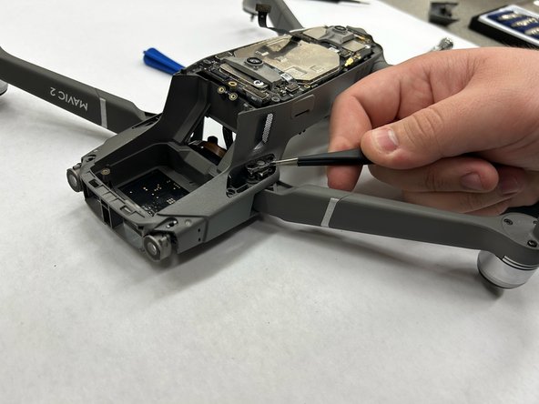

  4. Mavic 2 Arm Replacement: crwdns2935265:04crwdnd2935265:01crwdnd2935265:02crwdne2935265:0 Mavic 2 Arm Replacement: crwdns2935265:04crwdnd2935265:02crwdnd2935265:02crwdne2935265:0
    • Using tweezers or a plastic pick, remove either the white or black wire plugging into the board.
    • Be gentle removing the wire from the plug, you can damage the plug on the board.
    • The wire being pulled depends on which arm is being replaced. The wire that is closest to the arm being replaced is the one to unplug.

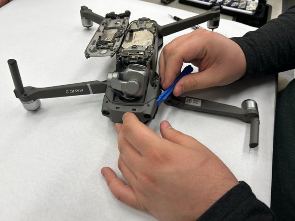

  5. Mavic 2 Arm Replacement: crwdns2935265:05crwdnd2935265:01crwdnd2935265:03crwdne2935265:0 Mavic 2 Arm Replacement: crwdns2935265:05crwdnd2935265:02crwdnd2935265:03crwdne2935265:0 Mavic 2 Arm Replacement: crwdns2935265:05crwdnd2935265:03crwdnd2935265:03crwdne2935265:0
    • Unscrew the two M2x5 screws holding on the front nose.
    • Using a plastic pry tool, gently pry along the seem around the front nose to remove it.

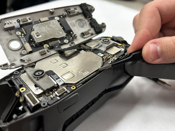

  7. Mavic 2 Arm Replacement: crwdns2935265:07crwdnd2935265:01crwdnd2935265:03crwdne2935265:0 Mavic 2 Arm Replacement: crwdns2935265:07crwdnd2935265:02crwdnd2935265:03crwdne2935265:0 Mavic 2 Arm Replacement: crwdns2935265:07crwdnd2935265:03crwdnd2935265:03crwdne2935265:0
    • Using a plastic pry tool, pry along the seem around the top cover to separate it from the chassis. Be patient as it does take a bit of time and effort to get it off.

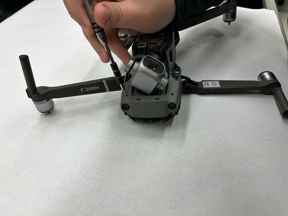

  8. Mavic 2 Arm Replacement: crwdns2935265:08crwdnd2935265:01crwdnd2935265:02crwdne2935265:0 Mavic 2 Arm Replacement: crwdns2935265:08crwdnd2935265:02crwdnd2935265:02crwdne2935265:0
    • Use a Phillips #0 screwdriver to remove the screw that secures the arm spring.
    • Then remove the spring, use either tweezers or a flat-head screwdriver to lift it up out of the arm.
  9. Mavic 2 Arm Replacement: crwdns2935265:09crwdnd2935265:01crwdnd2935265:02crwdne2935265:0 Mavic 2 Arm Replacement: crwdns2935265:09crwdnd2935265:02crwdnd2935265:02crwdne2935265:0
    • On the topside of the drone,desolder the wires from the main board that correspond to the arm trying to be replaced, there should be six in total.
    • Remove the arm once all wires are desoldered.
    • Make note of where each wire goes on the board as the colors may not be the same across all models.
