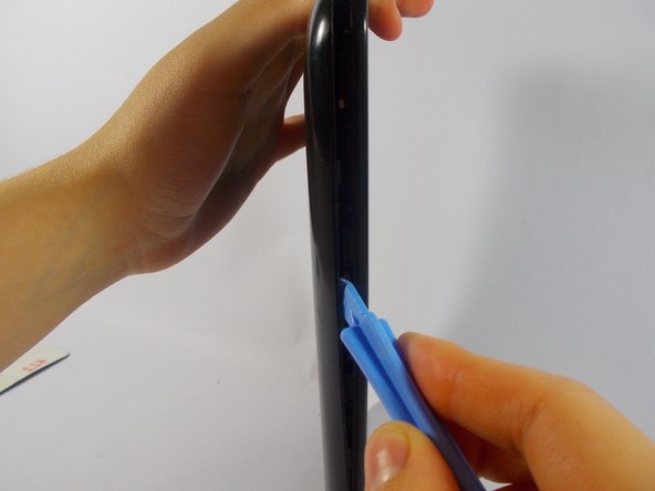

    • Place the device face down on a flat surface.
    • Insert one of the wide tipped, plastic opening tools into the top of the left speaker slot.
    • Potential for device damage: Be sure not to puncture the covering of the speaker.
    • Pry the back plate open and slide the tool in a clockwise direction, moving it along the opening between the device and its back plate until you reach the power button.

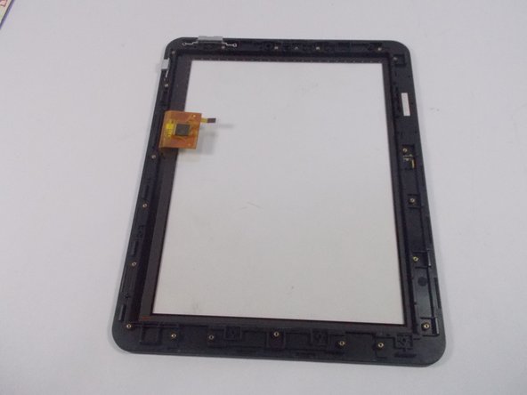

  5. Matsunichi MarquisPad MP977 Plastic Front Panel Replacement: crwdns2935265:05crwdnd2935265:01crwdnd2935265:01crwdne2935265:0
    • Remove the screws holding the metal frame plate in place.
    • Remove the metal frame plate from the plastic housing.
  6. Matsunichi MarquisPad MP977 Plastic Front Panel Replacement: crwdns2935265:06crwdnd2935265:01crwdnd2935265:02crwdne2935265:0 Matsunichi MarquisPad MP977 Plastic Front Panel Replacement: crwdns2935265:06crwdnd2935265:02crwdnd2935265:02crwdne2935265:0
    • Place the metal frame plate and components into the new plastic front panel.
