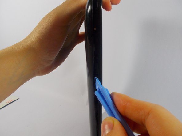

    • Insert the wide-tipped plastic opening tool into the top of the left speaker slot.
    • Potential for device damage: Do not puncture the speaker cover.
    • Pry the back plate open and slide the tool in a clockwise direction, moving it along the opening between the device and the back plate until you reach the power button.
  3. Matsunichi MarquisPad MP977 Front Facing Camera Replacement: crwdns2935265:03crwdnd2935265:01crwdnd2935265:02crwdne2935265:0 Matsunichi MarquisPad MP977 Front Facing Camera Replacement: crwdns2935265:03crwdnd2935265:02crwdnd2935265:02crwdne2935265:0
    • Insert the opening tool into the slot to the right of the speaker on the top edge of the device.
    • Pry open the back plate of the device, and slide the tool counter clockwise along the device until you reach the charging port.

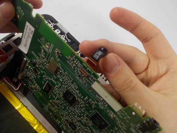

    • Remove the seven screws holding in the motherboard using a Phillips #00 screwdriver.
  6. Matsunichi MarquisPad MP977 Front Facing Camera Replacement: crwdns2935265:06crwdnd2935265:01crwdnd2935265:02crwdne2935265:0 Matsunichi MarquisPad MP977 Front Facing Camera Replacement: crwdns2935265:06crwdnd2935265:02crwdnd2935265:02crwdne2935265:0
    • Gently pull the camera optic fiber out of its slot to release the flap. This will allow the flap to open easily.
    • Be sure not to damage the camera port.

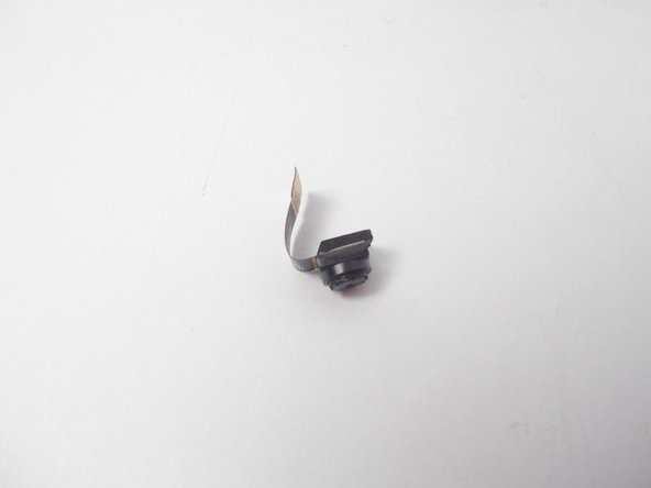

  7. Matsunichi MarquisPad MP977 Front Facing Camera Replacement: crwdns2935265:07crwdnd2935265:01crwdnd2935265:02crwdne2935265:0 Matsunichi MarquisPad MP977 Front Facing Camera Replacement: crwdns2935265:07crwdnd2935265:02crwdnd2935265:02crwdne2935265:0
    • Insert the new camera into the pinhole camera slot.
