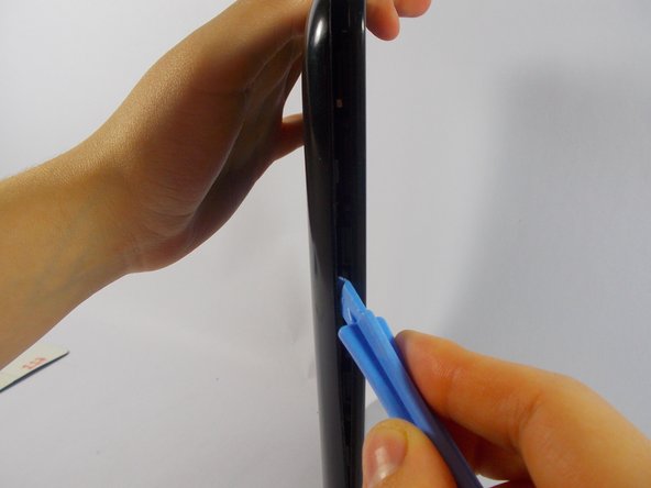

    • Place the device face down on a flat surface.
    • Insert one of the wide-tipped, plastic opening tools into the top of the left speaker slot.
    • Be sure to avoid puncturing the covering of the speaker.
    • Pry the back plate open and slide the tool in a clockwise direction, moving it along the opening between the device and its back plate until you reach the power button.
  3. Matsunichi MarquisPad MP977 Battery Replacement: crwdns2935265:03crwdnd2935265:01crwdnd2935265:02crwdne2935265:0 Matsunichi MarquisPad MP977 Battery Replacement: crwdns2935265:03crwdnd2935265:02crwdnd2935265:02crwdne2935265:0
    • Insert the opening tool into the right speaker slot.
    • Pry open the back plate, and slide the tool counterclockwise along the device until you reach the charging port.
  4. Matsunichi MarquisPad MP977 Battery Replacement: crwdns2935265:04crwdnd2935265:01crwdnd2935265:01crwdne2935265:0
    • Remove the back plate and place it to the side.

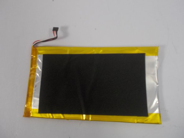

  5. Matsunichi MarquisPad MP977 Battery Replacement: crwdns2935265:05crwdnd2935265:01crwdnd2935265:02crwdne2935265:0 Matsunichi MarquisPad MP977 Battery Replacement: crwdns2935265:05crwdnd2935265:02crwdnd2935265:02crwdne2935265:0
    • Detach the battery from the motherboard.
