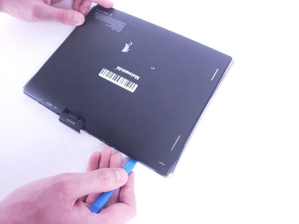

    • Use the iFixit opening tool to pry off the back cover of the device.
    • The volume buttons and the lock switch will come loose when the back comes off.

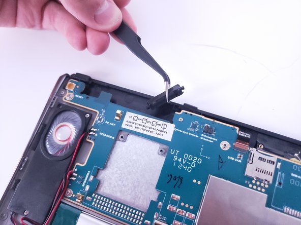

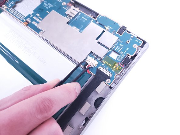

    • Use a pair of tweezers to disconnect the battery from the motherboard.
  5. Matsunichi M97 9 inch Screen Replacement: crwdns2935265:05crwdnd2935265:01crwdnd2935265:02crwdne2935265:0 Matsunichi M97 9 inch Screen Replacement: crwdns2935265:05crwdnd2935265:02crwdnd2935265:02crwdne2935265:0

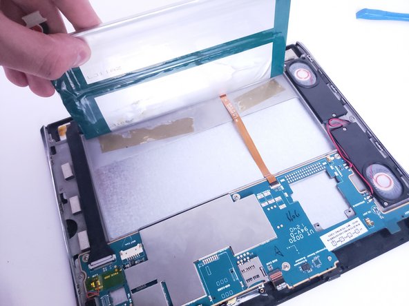

    • Carefully unstick the battery from the frame using the spudger.
    • Do not bend or puncture the battery during removal.

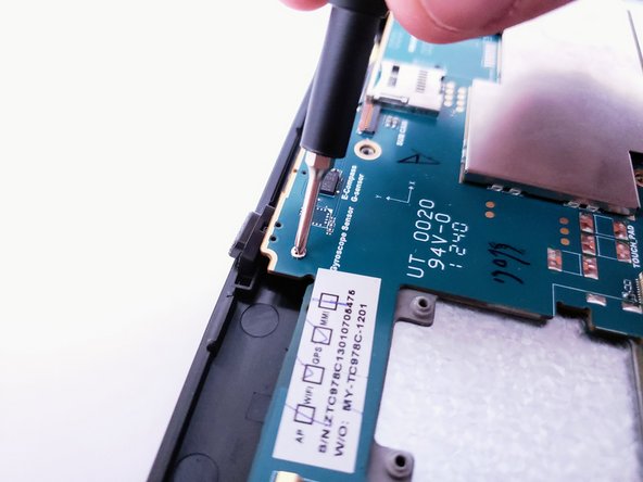

  6. Matsunichi M97 9 inch Screen Replacement, Motherboard: crwdns2935265:06crwdnd2935265:01crwdnd2935265:02crwdne2935265:0 Matsunichi M97 9 inch Screen Replacement, Motherboard: crwdns2935265:06crwdnd2935265:02crwdnd2935265:02crwdne2935265:0
    • Remove the six 2mm screws that hold the motherboard onto the case using the Phillips #00 screwdriver.
    • Use the same screwdriver to remove the single 4mm screw.

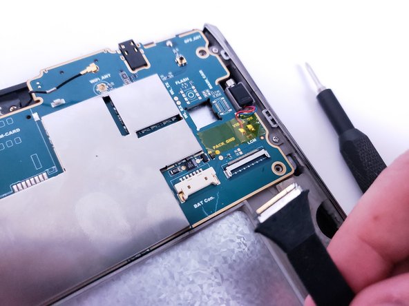

    • Gently pull the display ribbon cable to unplug it from the motherboard.
  8. Matsunichi M97 9 inch Screen Replacement: crwdns2935265:08crwdnd2935265:01crwdnd2935265:01crwdne2935265:0
    • Use a spudger or an iFixit opening tool to lift the locking mechanism holding the camera ribbon cable.

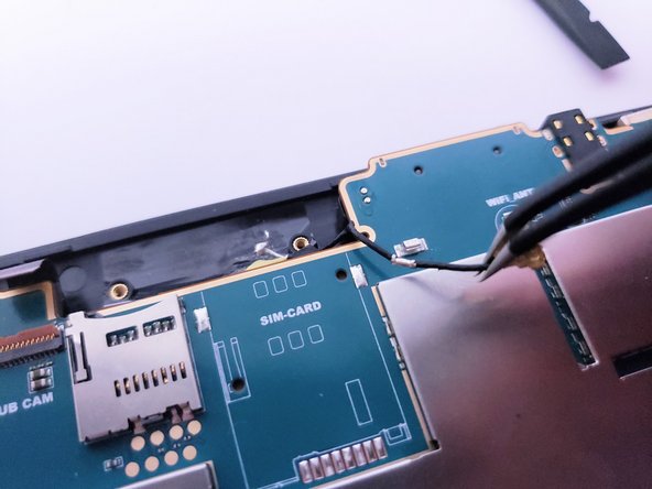

  9. Matsunichi M97 9 inch Screen Replacement: crwdns2935265:09crwdnd2935265:01crwdnd2935265:02crwdne2935265:0 Matsunichi M97 9 inch Screen Replacement: crwdns2935265:09crwdnd2935265:02crwdnd2935265:02crwdne2935265:0

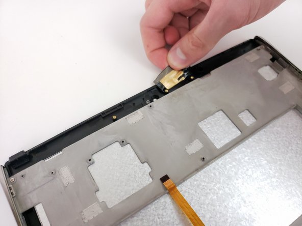

    • Lift up on the wifi antenna cable to unsnap it from the motherboard.
    • Then unhook the cable from the holding bracket.

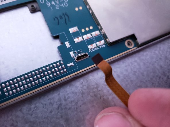

    • Use the spudger or iFixit opening tool to lift up on the locking mechanism for the digitizer ribbon cable.
    • Pull the cable from its connection.

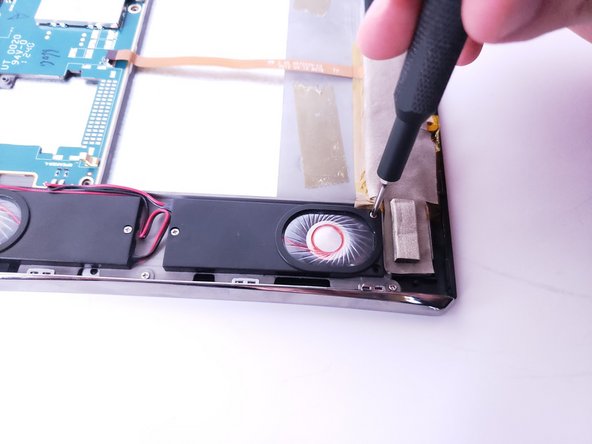

    • Use the Phillips #00 screwdriver to remove the four 4mm screws that hold the speakers in place.
  12. Matsunichi M97 9 inch Screen Replacement: crwdns2935265:012crwdnd2935265:01crwdnd2935265:01crwdne2935265:0
    • Pull the vibration motor out of its housing.

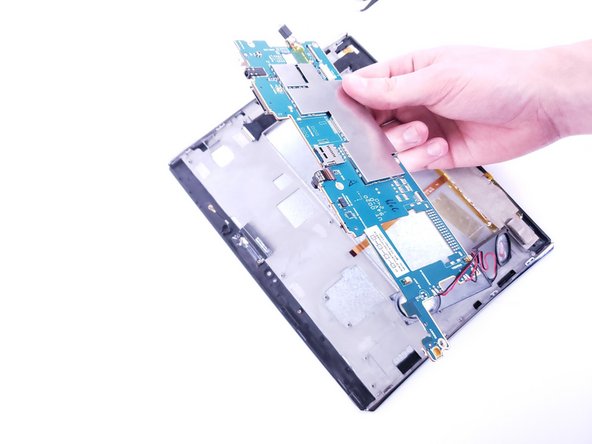

  13. Matsunichi M97 9 inch Screen Replacement: crwdns2935265:013crwdnd2935265:01crwdnd2935265:02crwdne2935265:0 Matsunichi M97 9 inch Screen Replacement: crwdns2935265:013crwdnd2935265:02crwdnd2935265:02crwdne2935265:0
    • Lift the motherboard off the frame.

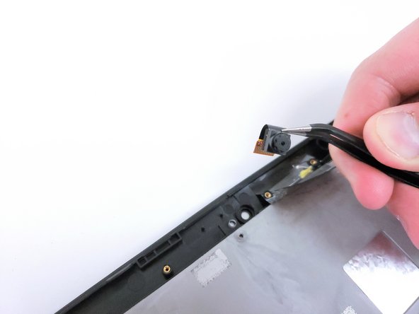

  14. Matsunichi M97 9 inch Screen Replacement, Camera: crwdns2935265:014crwdnd2935265:01crwdnd2935265:02crwdne2935265:0 Matsunichi M97 9 inch Screen Replacement, Camera: crwdns2935265:014crwdnd2935265:02crwdnd2935265:02crwdne2935265:0
    • Remove the camera from the device.

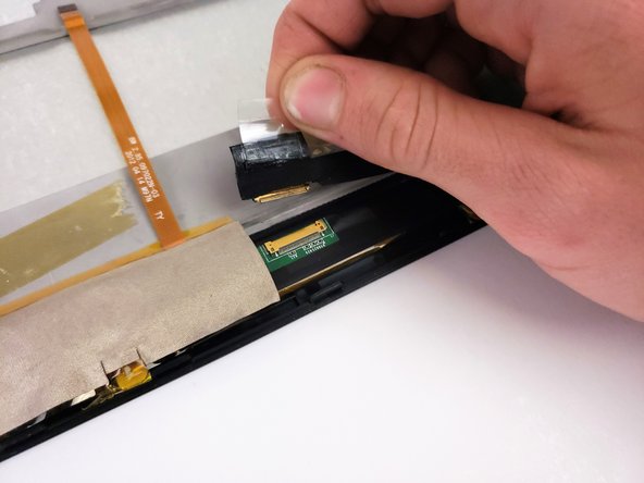

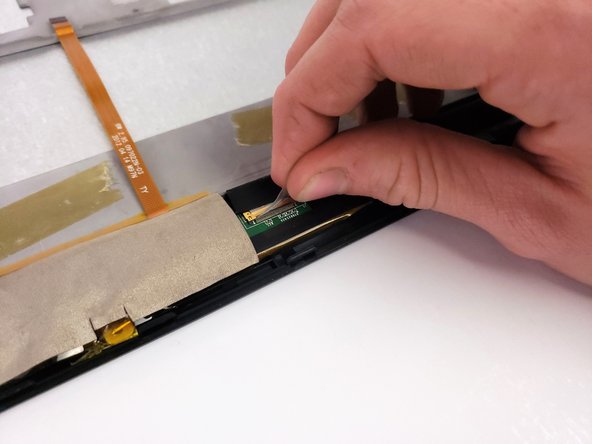

  15. Matsunichi M97 9 inch Screen Replacement, Screen: crwdns2935265:015crwdnd2935265:01crwdnd2935265:03crwdne2935265:0 Matsunichi M97 9 inch Screen Replacement, Screen: crwdns2935265:015crwdnd2935265:02crwdnd2935265:03crwdne2935265:0 Matsunichi M97 9 inch Screen Replacement, Screen: crwdns2935265:015crwdnd2935265:03crwdnd2935265:03crwdne2935265:0
    • Peel off the black and the clear tape covering the display cable connection.
    • Pull the display cable to disconnect it from the display.
  16. Matsunichi M97 9 inch Screen Replacement: crwdns2935265:016crwdnd2935265:01crwdnd2935265:02crwdne2935265:0 Matsunichi M97 9 inch Screen Replacement: crwdns2935265:016crwdnd2935265:02crwdnd2935265:02crwdne2935265:0

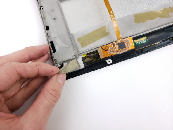

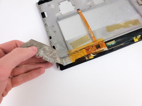

    • Peel off the conductive tape covering the display board.
  17. Matsunichi M97 9 inch Screen Replacement: crwdns2935265:017crwdnd2935265:01crwdnd2935265:02crwdne2935265:0 Matsunichi M97 9 inch Screen Replacement: crwdns2935265:017crwdnd2935265:02crwdnd2935265:02crwdne2935265:0

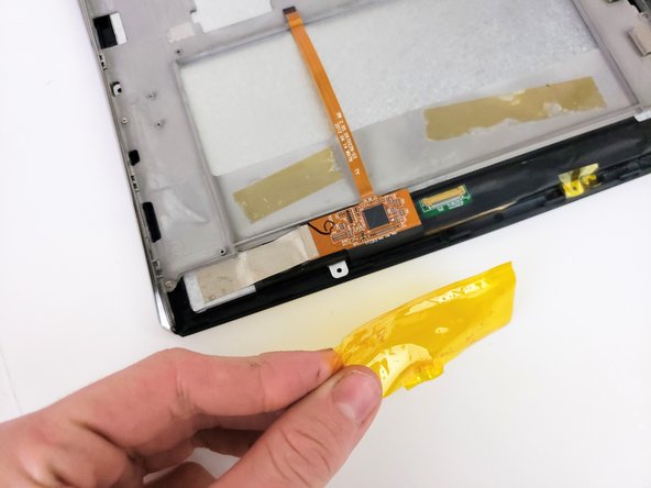

    • Peel off the Kapton thermal tape from the display board.
  18. Matsunichi M97 9 inch Screen Replacement: crwdns2935265:018crwdnd2935265:01crwdnd2935265:02crwdne2935265:0 Matsunichi M97 9 inch Screen Replacement: crwdns2935265:018crwdnd2935265:02crwdnd2935265:02crwdne2935265:0
    • Peel off the grounding tape attached to the display board.
  19. Matsunichi M97 9 inch Screen Replacement: crwdns2935265:019crwdnd2935265:01crwdnd2935265:02crwdne2935265:0 Matsunichi M97 9 inch Screen Replacement: crwdns2935265:019crwdnd2935265:02crwdnd2935265:02crwdne2935265:0
    • Peel off the black tape near the wifi antenna from the frame.
    • Do not pull the tape completely off to avoid damage to the wifi antenna.

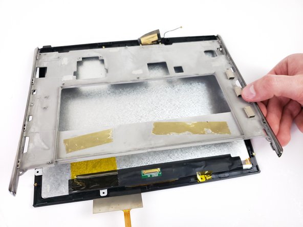

  20. Matsunichi M97 9 inch Screen Replacement: crwdns2935265:020crwdnd2935265:01crwdnd2935265:02crwdne2935265:0 Matsunichi M97 9 inch Screen Replacement: crwdns2935265:020crwdnd2935265:02crwdnd2935265:02crwdne2935265:0
    • Using the Phillips #00 screwdriver, unscrew the seven 4mm screws holding the frame to the front glass.
    • Gently lift the frame off the LCD panel
  21. Matsunichi M97 9 inch Screen Replacement: crwdns2935265:021crwdnd2935265:01crwdnd2935265:01crwdne2935265:0
    • Lift up the LCD panel from the glass digitizer.
