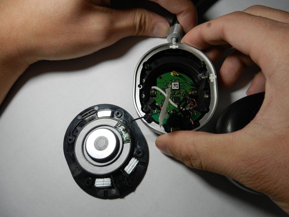

  4. Master and Dynamic MW50 Wireless Connector Replacement, Wireless Connector: crwdns2935265:04crwdnd2935265:01crwdnd2935265:03crwdne2935265:0 Master and Dynamic MW50 Wireless Connector Replacement, Wireless Connector: crwdns2935265:04crwdnd2935265:02crwdnd2935265:03crwdne2935265:0 Master and Dynamic MW50 Wireless Connector Replacement, Wireless Connector: crwdns2935265:04crwdnd2935265:03crwdnd2935265:03crwdne2935265:0
    • Remove the 2mm screw holding the side cover plate in place with a JIS #00 screwdriver.
    • Move the side cover off to the side.
    • The black cable connected to the motherboard from the side cover can be gently pulled off from the motherboard side. It isn't soldered on.

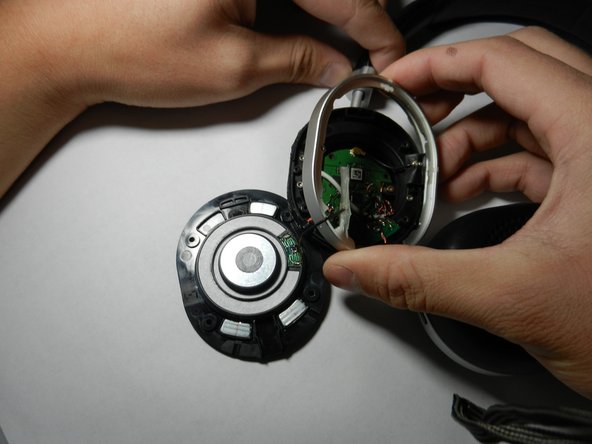

  5. Master and Dynamic MW50 Wireless Connector Replacement: crwdns2935265:05crwdnd2935265:01crwdnd2935265:01crwdne2935265:0
    • Pull the black tape holding the connector in place.
  6. Master and Dynamic MW50 Wireless Connector Replacement: crwdns2935265:06crwdnd2935265:01crwdnd2935265:01crwdne2935265:0
    • Desolder the connector from the motherboard.
    • Refer to this picture for soldering the connector back to the motherboard.
  7. Master and Dynamic MW50 Wireless Connector Replacement: crwdns2935265:07crwdnd2935265:01crwdnd2935265:01crwdne2935265:0
    • Solder the new Bluetooth connector into place.
