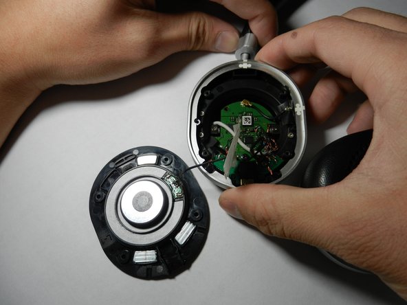

    • Use the Jimmy to lift up the black cover to get inside the device.
  4. Master and Dynamic MW50 Motherboard Replacement, Motherboard: crwdns2935265:04crwdnd2935265:01crwdnd2935265:03crwdne2935265:0 Master and Dynamic MW50 Motherboard Replacement, Motherboard: crwdns2935265:04crwdnd2935265:02crwdnd2935265:03crwdne2935265:0 Master and Dynamic MW50 Motherboard Replacement, Motherboard: crwdns2935265:04crwdnd2935265:03crwdnd2935265:03crwdne2935265:0
    • Remove the 2mm screw holding the side cover plate in place with a JIS #00 screwdriver.
    • Move the side cover off to the side.
    • The black cable connected to the motherboard from the side cover can be gently pulled off from the motherboard side. It isn't soldered on.

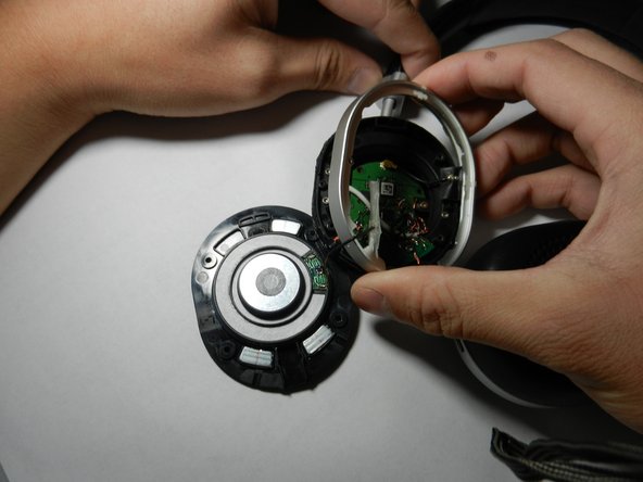

  5. Master and Dynamic MW50 Motherboard Replacement: crwdns2935265:05crwdnd2935265:01crwdnd2935265:01crwdne2935265:0
    • Desolder all the wires connected to the motherboard.
    • Refer to this picture for soldering the wires on the new motherboard.
  6. Master and Dynamic MW50 Motherboard Replacement: crwdns2935265:06crwdnd2935265:01crwdnd2935265:01crwdne2935265:0
    • Remove the two 2mm screws holding the motherboard in place.
  7. Master and Dynamic MW50 Motherboard Replacement: crwdns2935265:07crwdnd2935265:01crwdnd2935265:01crwdne2935265:0
    • Replace with new motherboard.
To reassemble your device, follow these instructions in reverse order. You may want to use the picture from Step 5 to correctly re-solder your device.
