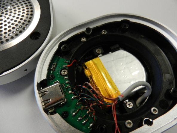

  5. Master and Dynamic MW50 Charging Port Replacement: crwdns2935265:05crwdnd2935265:01crwdnd2935265:01crwdne2935265:0
    • Remove the two 2mm screws shown with a JIS #00 screwdriver.
  6. Master and Dynamic MW50 Charging Port Replacement: crwdns2935265:06crwdnd2935265:01crwdnd2935265:01crwdne2935265:0
    • Lift up the mother board with the attached charging port to see the soldering points. You must desolder these points in order to detach (and re-attach) the charging port.
