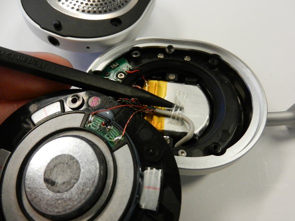

    • Use the Jimmy to lift up the black cover to get inside the device.
  4. Master and Dynamic MW50 Battery Replacement, Battery: crwdns2935265:04crwdnd2935265:01crwdnd2935265:02crwdne2935265:0 Master and Dynamic MW50 Battery Replacement, Battery: crwdns2935265:04crwdnd2935265:02crwdnd2935265:02crwdne2935265:0
    • Remove the tape attaching the thicker white wire to the battery. You may consider keeping the tape to reattach the wire later.

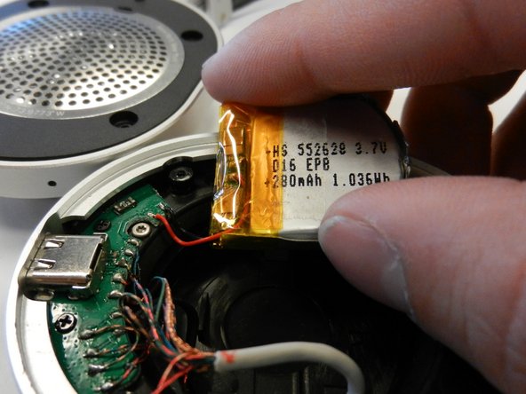

    • Desolder the two wires circled here.
  6. Master and Dynamic MW50 Battery Replacement: crwdns2935265:06crwdnd2935265:01crwdnd2935265:02crwdne2935265:0 Master and Dynamic MW50 Battery Replacement: crwdns2935265:06crwdnd2935265:02crwdnd2935265:02crwdne2935265:0
    • Use an iFixit opening tool or something similar to pry out the battery.
    • There are two small tabs circled here that are holding the battery in. Push these down while prying to make the battery come out easier.
