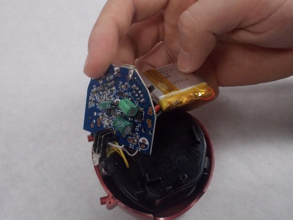

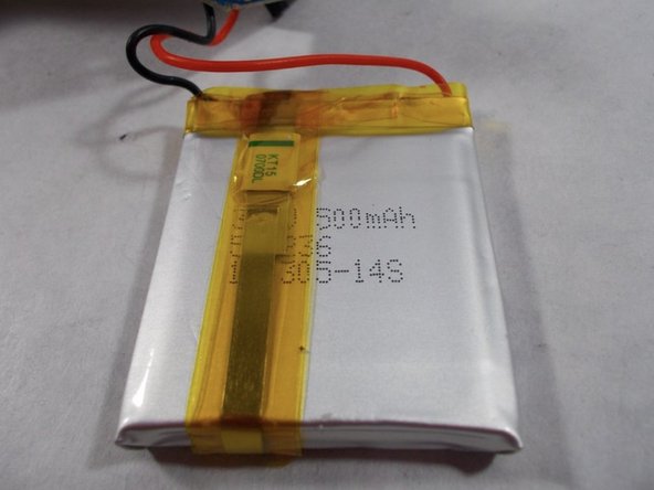

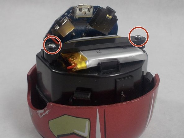

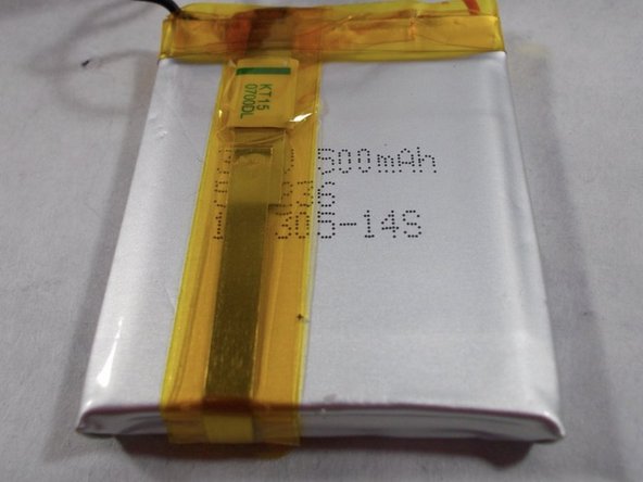

    • Remove the two screws on the battery cover.
    • Remove the battery cover. The battery should become loose as shown in the picture.

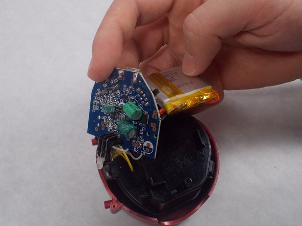

    • Gently lift the battery from the rest of the front assembly to stretch the wires out slightly. Gently let the battery hang from the side of the device.

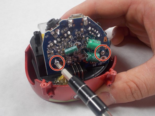

    • Remove the two screws keeping the motherboard in place.
    • Gently lift the motherboard from the rest of the front assembly to stretch the wires out slightly.
    • When taking out the motherboard, gently press the top of the LED away from the assembly while pulling upwards on the motherboard. This allows the light to lift out of its protective area while the motherboard is being taken out.

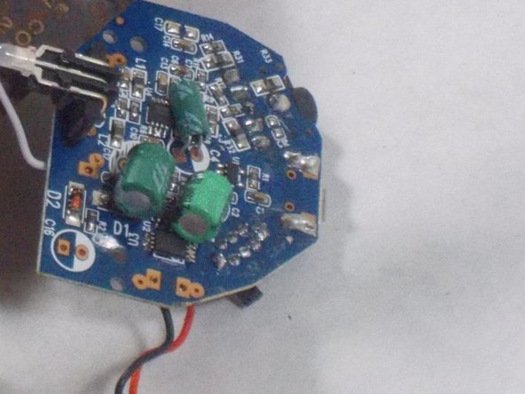

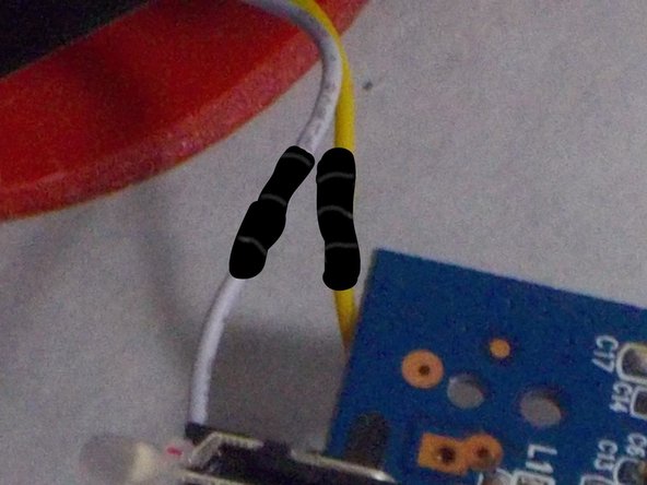

  8. Marvel iHome MR-M66 Speaker Assembly Replacement: crwdns2935265:08crwdnd2935265:01crwdnd2935265:03crwdne2935265:0 Marvel iHome MR-M66 Speaker Assembly Replacement: crwdns2935265:08crwdnd2935265:02crwdnd2935265:03crwdne2935265:0 Marvel iHome MR-M66 Speaker Assembly Replacement: crwdns2935265:08crwdnd2935265:03crwdnd2935265:03crwdne2935265:0
    • Cut one of the wires with wire cutters about an inch away from where the motherboard connects to the speaker assembly.
    • Repeat with the second wire.
    • Remove the motherboard and battery from the speaker assembly.
  9. Marvel iHome MR-M66 Speaker Assembly Replacement: crwdns2935265:09crwdnd2935265:01crwdnd2935265:02crwdne2935265:0 Marvel iHome MR-M66 Speaker Assembly Replacement: crwdns2935265:09crwdnd2935265:02crwdnd2935265:02crwdne2935265:0
    • Remove the old speaker assembly and place the new speaker assembly in the spot where the old speaker assembly was.
    • Twist the wire sticking out from the assembly with that of the motherboard so that they loop around each other. Add electrical tape around the wire connection.
