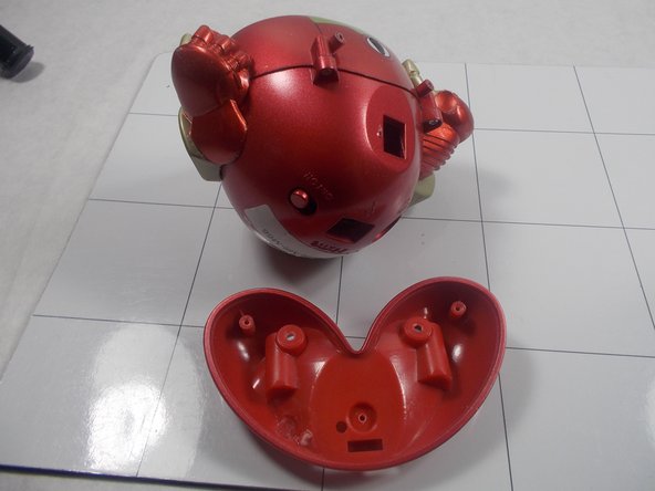

    • Remove two of the three screws shown on the bottom of the device.
    • Begin removing the last screw, but leave it partially in the socket to remove the bottom cover easier.
  2. Marvel iHome MR-M66 Power Switch Cover Replacement: crwdns2935265:02crwdnd2935265:01crwdnd2935265:03crwdne2935265:0 Marvel iHome MR-M66 Power Switch Cover Replacement: crwdns2935265:02crwdnd2935265:02crwdnd2935265:03crwdne2935265:0 Marvel iHome MR-M66 Power Switch Cover Replacement: crwdns2935265:02crwdnd2935265:03crwdnd2935265:03crwdne2935265:0
    • Remove the bottom cover by either pulling on the screw or using a plastic opening tool to pry the cover off.
    • After removing the bottom cover, remove the two screws.

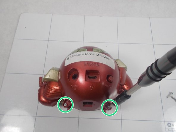

  3. Marvel iHome MR-M66 Power Switch Cover Replacement: crwdns2935265:03crwdnd2935265:01crwdnd2935265:03crwdne2935265:0 Marvel iHome MR-M66 Power Switch Cover Replacement: crwdns2935265:03crwdnd2935265:02crwdnd2935265:03crwdne2935265:0 Marvel iHome MR-M66 Power Switch Cover Replacement: crwdns2935265:03crwdnd2935265:03crwdnd2935265:03crwdne2935265:0
    • Use a spudger to release the small retaining clip that holds the feet to the bottom of the device.
    • Be careful here, as too much force can break the clip.
    • Remove the two screws from the back of the device.

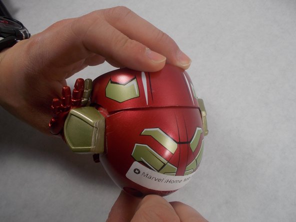

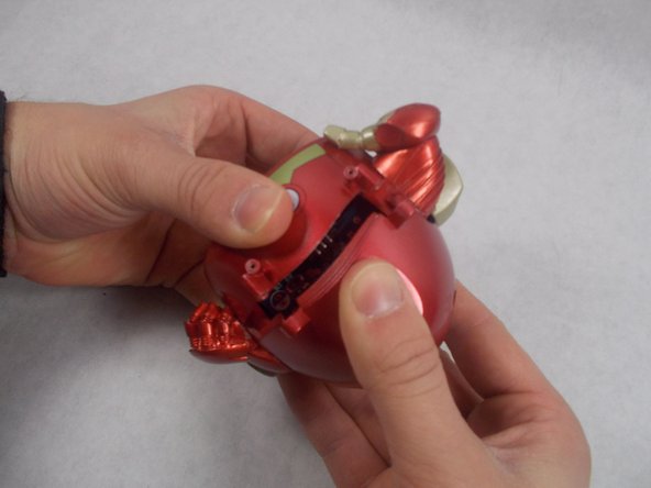

  4. Marvel iHome MR-M66 Power Switch Cover Replacement: crwdns2935265:04crwdnd2935265:01crwdnd2935265:03crwdne2935265:0 Marvel iHome MR-M66 Power Switch Cover Replacement: crwdns2935265:04crwdnd2935265:02crwdnd2935265:03crwdne2935265:0 Marvel iHome MR-M66 Power Switch Cover Replacement: crwdns2935265:04crwdnd2935265:03crwdnd2935265:03crwdne2935265:0
    • Using a plastic opening tool and your hand, separate the front and back covers from each other.
    • Starting from the bottom, use the plastic opening tool to create the initial separation and continue along the seam to the top of the device.
    • This step requires the most time and patience, so be careful.
    • The power switch will most likely come loose during this step and you will hear something rattling inside the device.

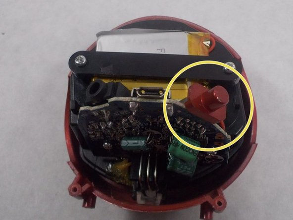

  5. Marvel iHome MR-M66 Power Switch Cover Replacement: crwdns2935265:05crwdnd2935265:01crwdnd2935265:03crwdne2935265:0 Marvel iHome MR-M66 Power Switch Cover Replacement: crwdns2935265:05crwdnd2935265:02crwdnd2935265:03crwdne2935265:0 Marvel iHome MR-M66 Power Switch Cover Replacement: crwdns2935265:05crwdnd2935265:03crwdnd2935265:03crwdne2935265:0
    • Remove the two arms from either side of the device once a significant separation has been created.
    • They are not fixed to the body itself so you should be able to wiggle them free.
    • Continue pulling the back cover off the device.
    • Remove the red cover for the on/off switch from the device.
