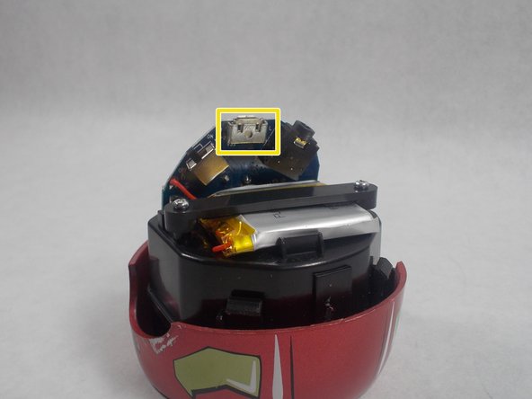

    • Locate the charging port on the edge of the top side of the circuitboard.
  9. Marvel iHome MR-M66 Charging Port Replacement: crwdns2935265:09crwdnd2935265:01crwdnd2935265:02crwdne2935265:0 Marvel iHome MR-M66 Charging Port Replacement: crwdns2935265:09crwdnd2935265:02crwdnd2935265:02crwdne2935265:0

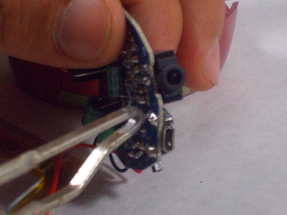

    • Locate the 4 metal pins on the bottom of the circuitboard connecting the charging port to the circuitboard.
    • Use the soldering iron to disconnect the pins.
    • Use a pair of tweezers to remove the old charging port.
    • Place the new charging port in the same spot and solder the port to the circuitboard.
